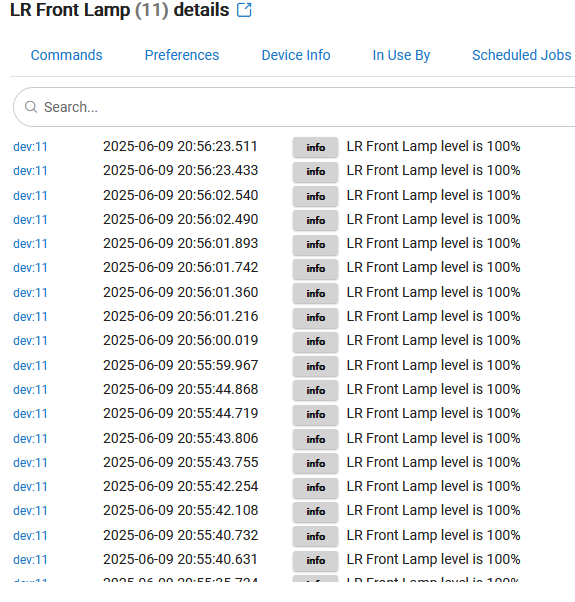

Attached are the logs. I don't have any way to see if the command to dim was done by HomeKit or the virtual button I have, but I tried Siri first, and it did nothing. Then I hit the virtual button on the app, and it dimmed the Back Lamp, but not Front Lamp. so I tried hitting the button a few times in a row, but for some reason Hubtiat keeps commanding the Front Lamp to go to 100% on every push, and the Back Lamp to 50% on every push.
FRONT LAMP log:
BACK LAMP log:
Yes you do, go to the device page and click o the Event tab. It shows commands there and what "produced" it.
I didn't know that, but looks like I have some answers. Looking at the event log, you can see where the command was called to set level, that was from pushing the virtual button, but then you see the command from HomeKit to turn the light on, which HomeKit wasn't used by me. So for some reason HomeKit is getting involved.
But, I have two lamps that are both controlled by that button, and the other one did dim, but then wouldn't brighten back up. I didn't have a chance to look at that log, but for at least that one time, it dimmed one lamp and not the other. And it seems to be at random.

If you go back to the logs I posted, and look at the first entry, that's what it does. It says that HomeKit commanded it on.
