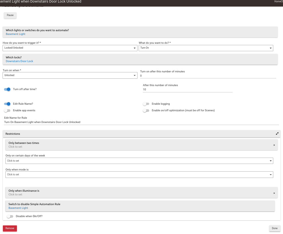

I'm doing that in simple rules. In my case, unlocking the basement door turns the basement lights on. I have it set to only fire if the light is already off. I don't want it turning lights back off if they were already on. (That's what the disable line at the bottom does)
Sorry for the text size. Had to make it small for everything to fit in one screenshot.

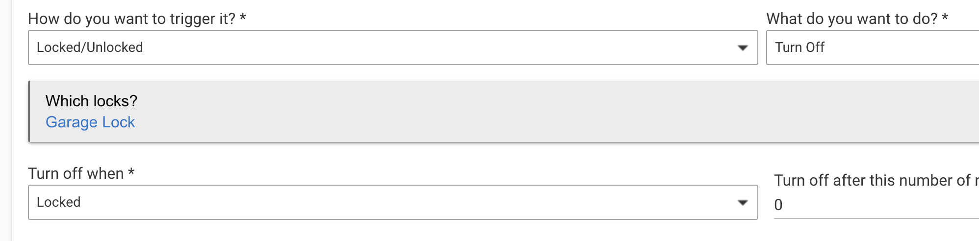

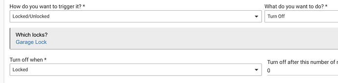

Since lock unlocks is an activation option then lock locks should be a deactivation option. @bravenel
It is:
Is that in Room Lighting? Why can't I find that?
That is Simple Automation Rules

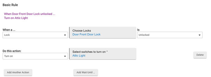

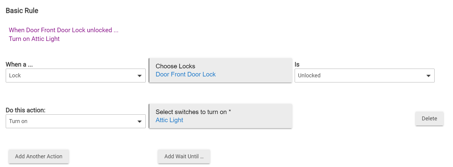

You can also do it in Basic Rules:
OK I'll migrate this automation to the Rules app.

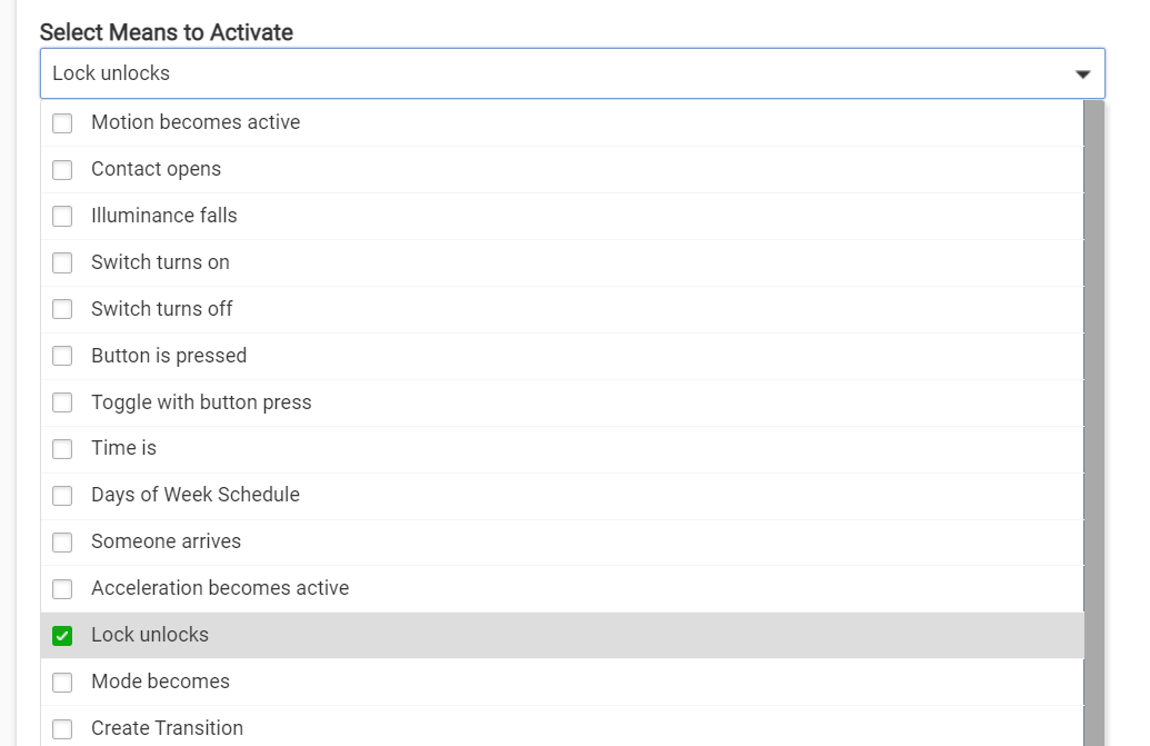

I haven't used it there, but it's in Room LIghting as well:

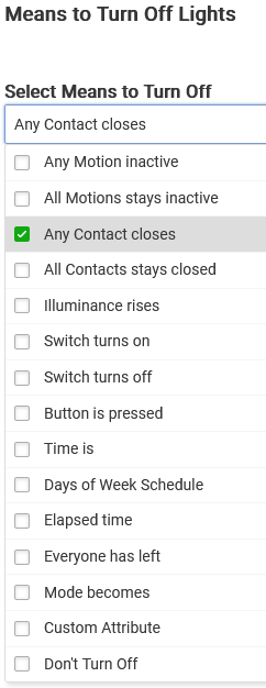

@danabw only as a means to activate (which I'm using), but inexplicably not as a means to deactivate.
+1. OP asked about Room Lighting. It is an option in means to turn on but not in the means to turn off.
Yeah, like I said I've never used that option in RL so hadn't seen that. No idea why locking only there as a means to activate.
