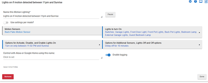

Below is a screen shot of the rule:
Would appreciate any insights that anyone has.

What is app:204? I'm guessing the Motion Ligthing app? (You can filter Logs to just specific apps or devices to make their entries easier to find.) If so, it looks like it's sending the "on" command to the device, so you probably don't have a problem with the app. More likely, you have a problem with the device. Leave the app out of the picture for a second and just try to turn on the devices directly from their device detail page. Does that work? If not, no app is going to work either -- any of them just run the same command.
This will help you figure out where to start troubleshooting, but if it's the device, knowing more about them would be helpful (manufacturer, model, or at least protocol, etc.).

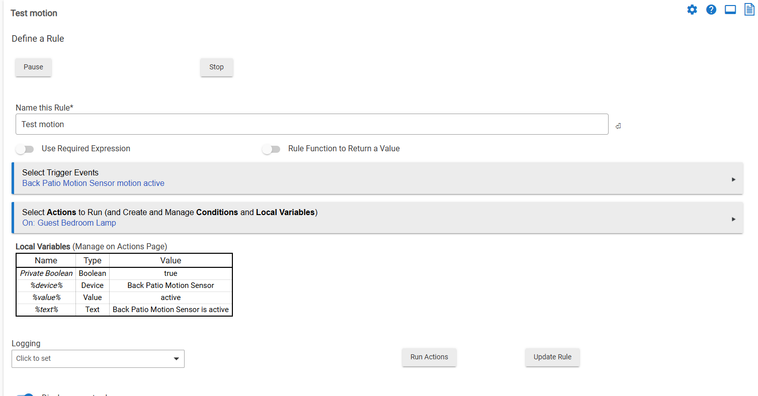

While I was trying to figure out the issue, I created a test rule to to turn on 1 light of motion is detected. That works fine:
It seems to have something to do with the condition I have set that I only want it to trigger between 1102pm and Sunrise.

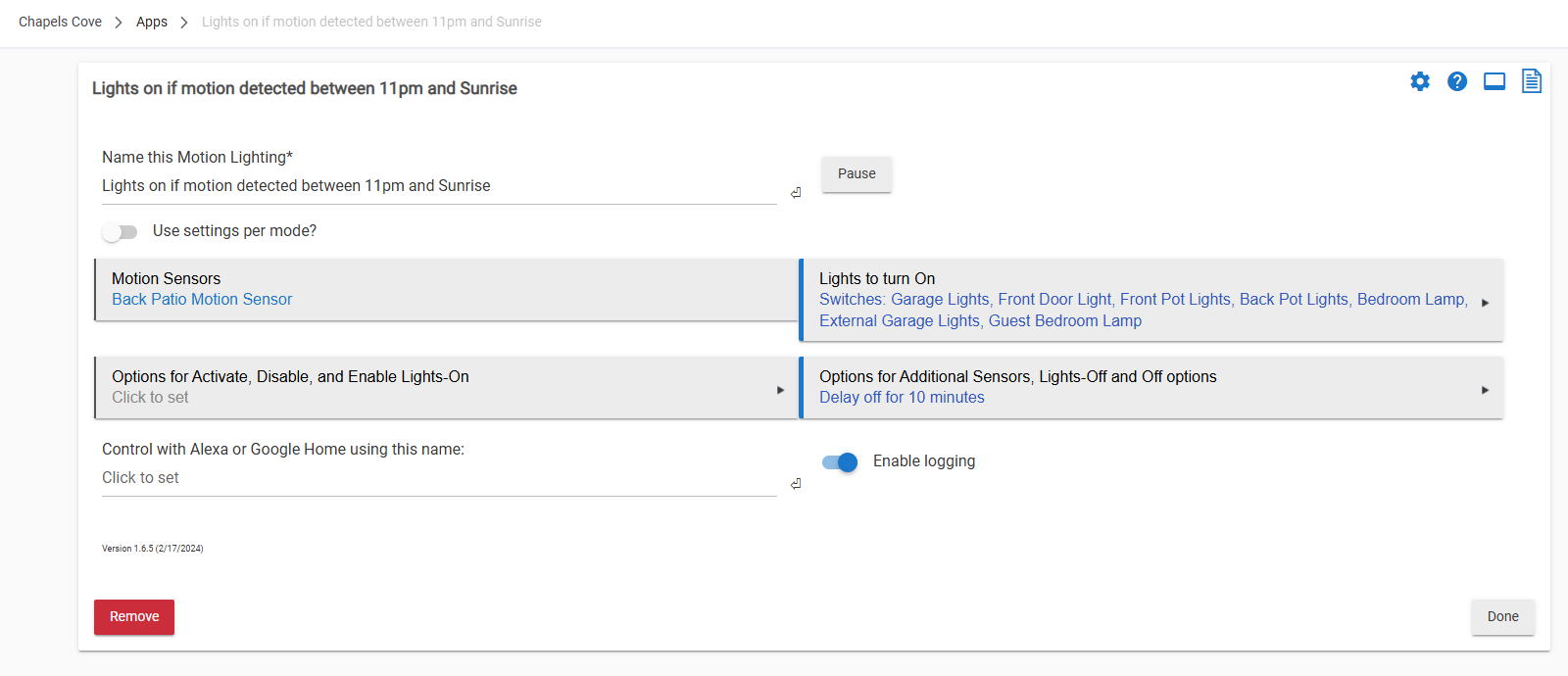

I erased the "Options for Activate, Disable and Enable Light-On" section. I triggered motion and all the selected lights came on:
Not sure if I have configured the settings within the section I erased properly.
