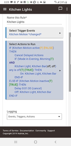

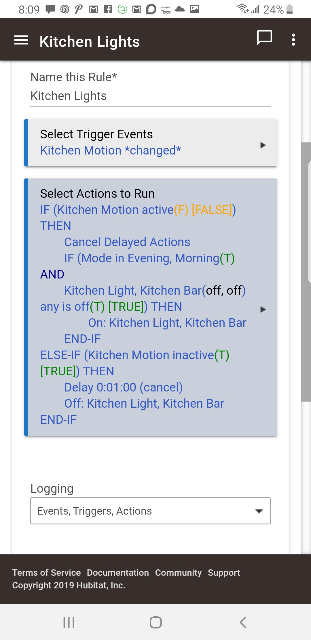

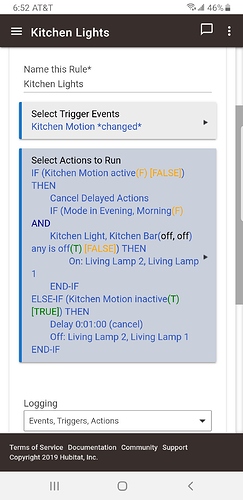

Ok something like this?
1 min for Kitchen
7 mins for Living room...
This one is for Kitchen
IF (Kitchen Motion active(F) [FALSE]) THEN
Cancel Delayed Actions
IF (Mode in Evening, Morning(F) AND
Kitchen Light, Kitchen Bar(off, off) any is off(T) [FALSE]) THEN
On: Living Lamp 2, Living Lamp 1
END-IF
ELSE-IF (Kitchen Motion inactive(T) [TRUE]) THEN
Delay 0:01:00 (cancel)
Off: Living Lamp 2, Living Lamp 1
END-IF
I think you missed changing the off to the kitchen lights but yeah, that's the general idea.
@Ryan780. Better?
You tell me. Do you want the kitchen motion sensor to turn off the living room light?
Yes I caught that when I was testing when I got home from work
