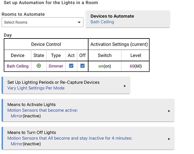

I have a GE26933 (dimmer with motion sensor) and Kasa HS220 (dimmer) installed on my bathroom. Created a rule to turn on lights on motion sensor/off (delay 3 min). I am using room lighting app and when a button is pressed on either device lights remain on, I would like to apply same rule of turning off (delay 3 min after no motion) when lights are on by motion or by touching any of the dimmers.

Can you post a screenshot of your rule?

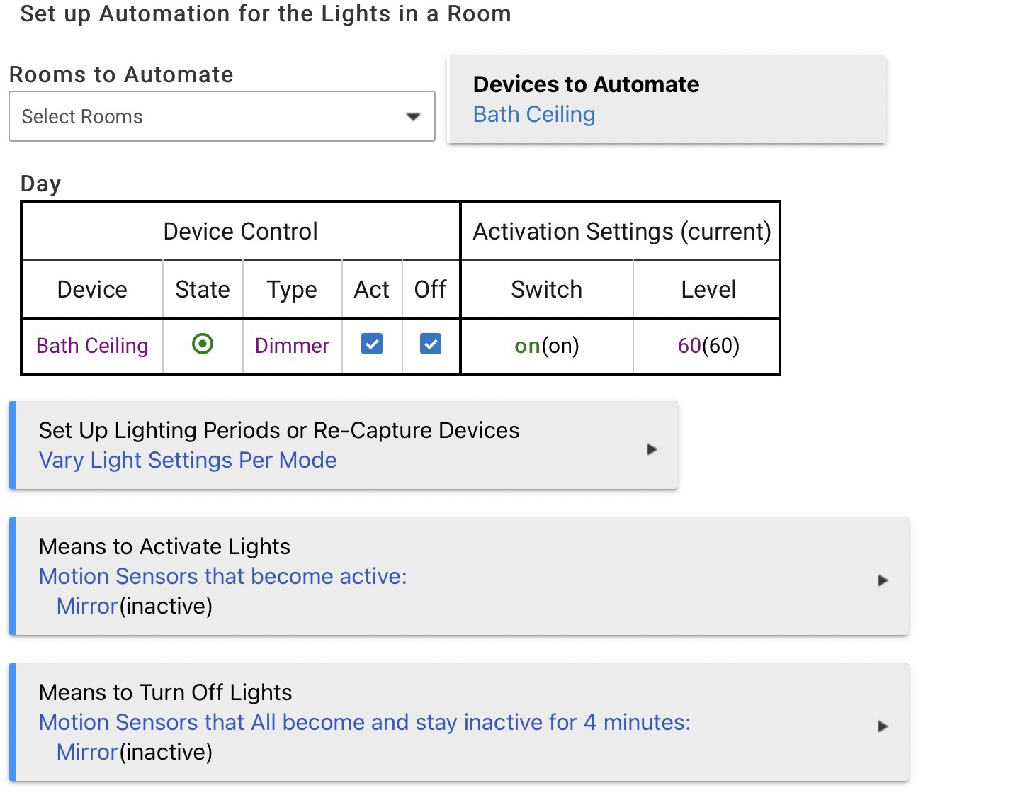

This is the automation of only one of the two lights in my bathroom. I have changed the means to turn off (different time delay after motion is not detected)

I don't think so. It is a very simple rule, but I need to add the option that is a button is pressed on either switch (to turn on or adjust light level) apply the same rule of turning off both switches after 3 minutes when motion is not detected
And you've tested and confirmed that if you use one of the switches to turn on or adjust the light, that 3 minutes after motion has ended, the light doesn't turn off?
