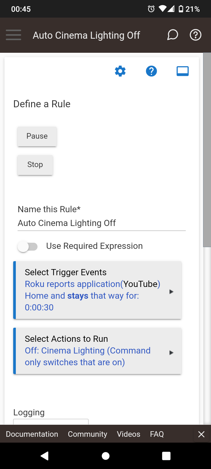

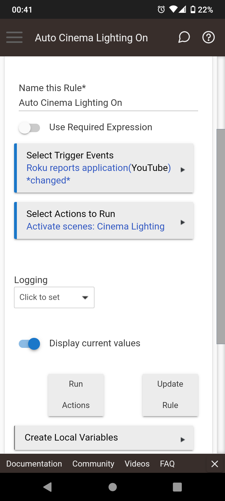

For my first RM automation I tried to set my Cinema Lighting scene to turn on when the Roku Streaming Stick+ is playing something, however the Cinema Lighting activates at random times-- I'm not sure why... It does not activate and when Roku is playing. I assume this is because I made a mistake my RM automation.

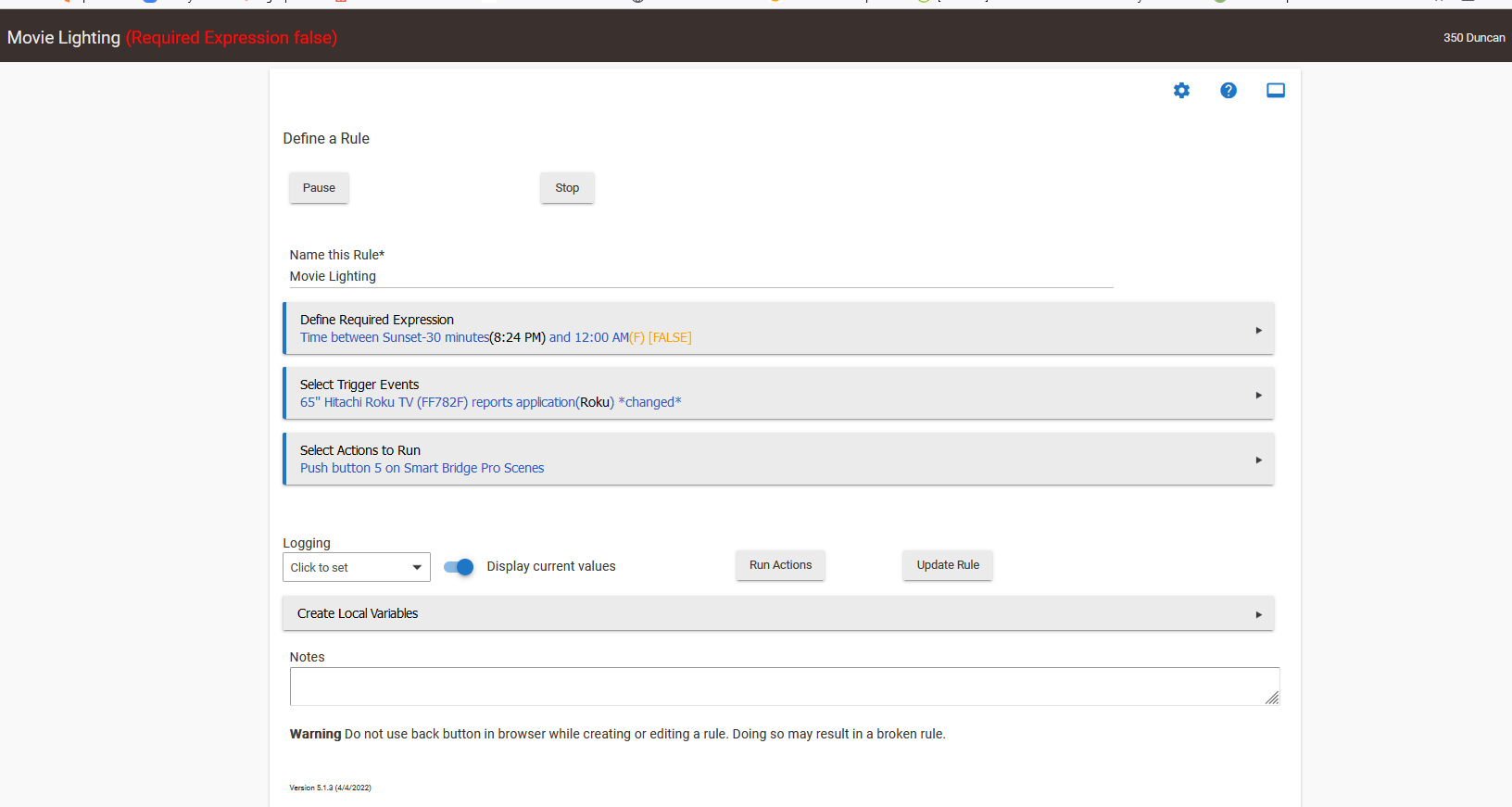

That looks like it should work. Check the scene itself and see what it's in use by... Or check a device within that scene to see what it's in use by. It could be used my multiple rules that are overlapping... I use this simple rule and it works quite well... It's trigger is pretty much the same as yours. You can test the overall rule with the run actions button...
Okay, I adjusted it to On: TransportStatus playing. Off: TransportStatus stopped and stays that way for 1 minute. These work, they just seems to have a 5 minute or so latency on both actions.
I'm not sure whether this is because WiZ lights are wifi bulbs (although the creator of the driver says they should be working locally) or because I have a Roku Streaming Stick+ rather than a Roku TV.
Run Actions in RM is instantaneous for both, though, so I suspect it's having trouble recognizing Roku Stick
