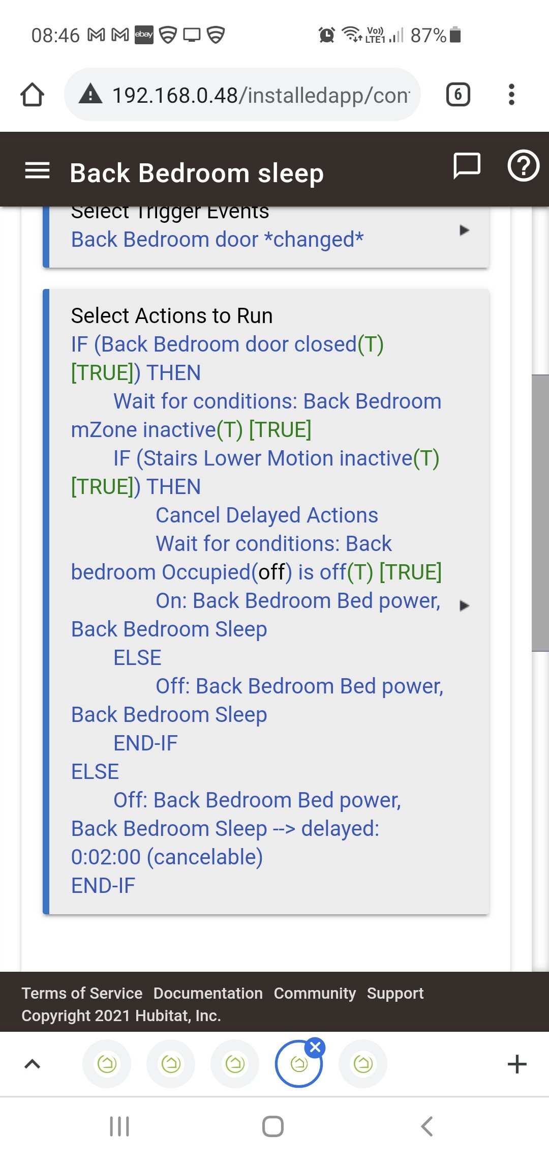

I have this rule to test what side of a door I am on when I close it. Might give you ideas
TRIGGER:
first motion sensor active
ACTIONS:
wait for second motion sensor (time out 1 min)
if second motion sensor is active then
turn on light
end-if
