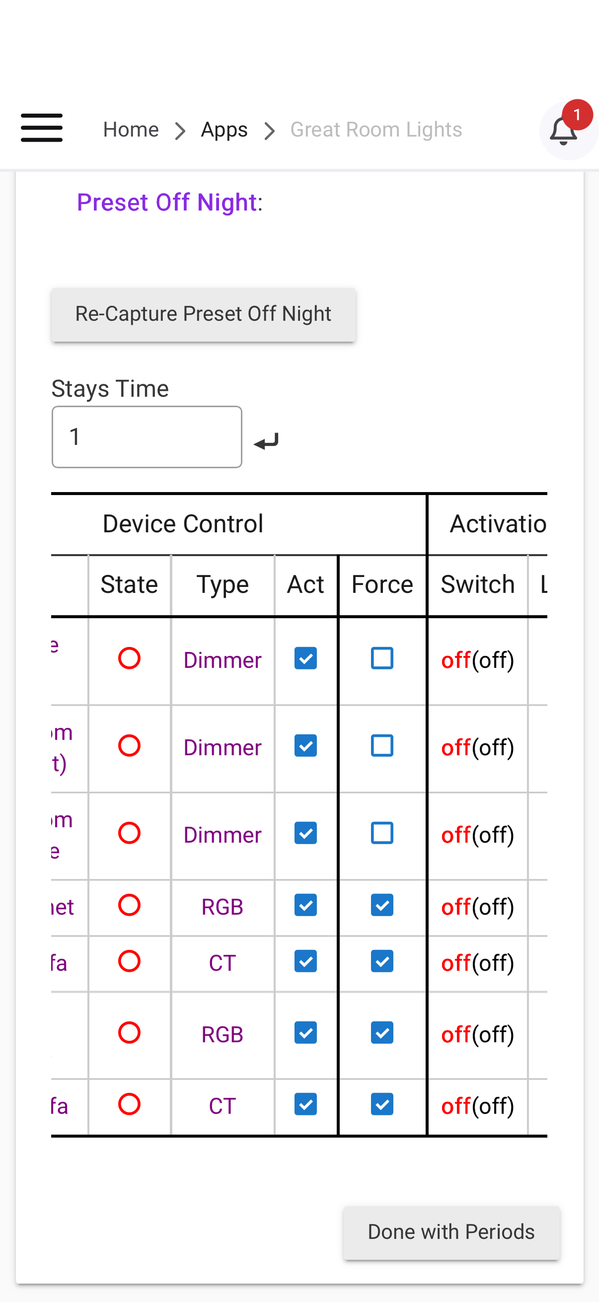

I have lamps and light strips that are on dim during the Evening mode when the main room lights are off. When my mode changes to Night, I want these lights to turn off. I also have these same lights set to off during the Day mode. When the room lights are on and the mode changes, the lights properly adjust. However, it seems that with the room off, mode changes are ignored.

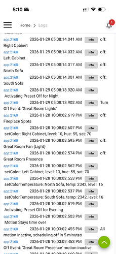

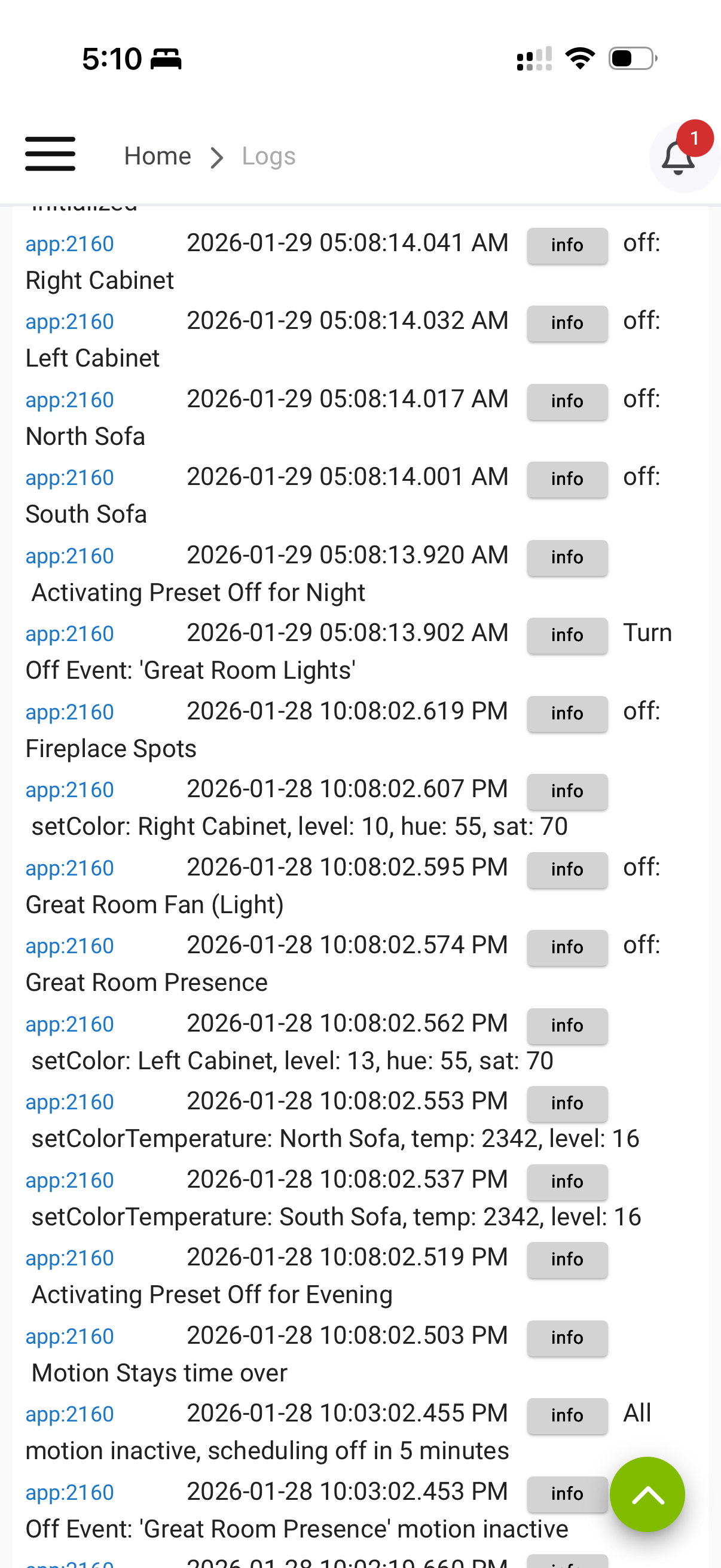

When I look at the logs, the changing of the mode while the room lights are “off”, does not trigger a change. If I manually select the Turn Off button after the mode has changed, the lights properly adjust.
Is this a bug, or do I not have a setting selected for the lights to change with mode changes when the lights are off?
My mode changes to night at 10:30 pm. The logs for my room lighting app shows no trigger at 10:30 pm. However, when I selected the Turn Off command manually in the morning, it did what it should have done.

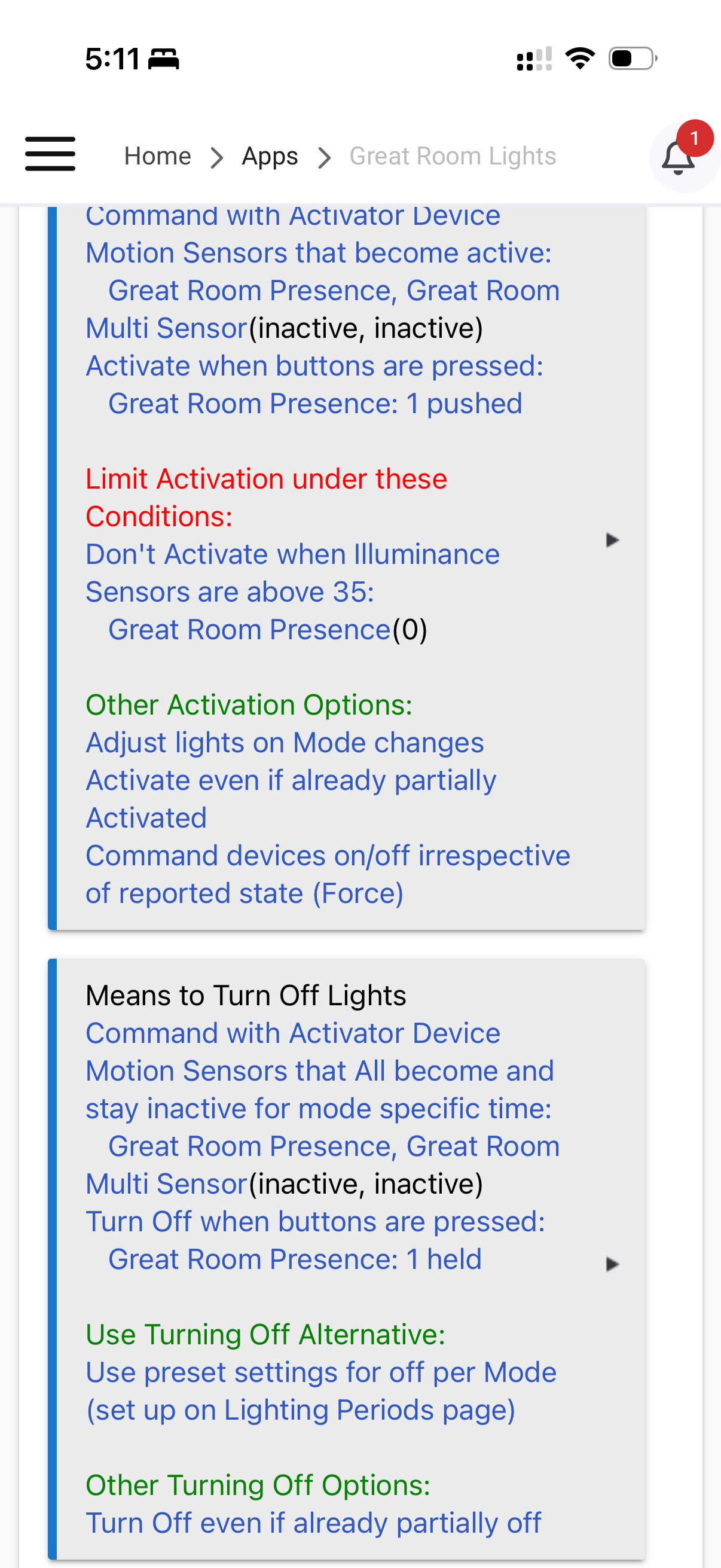

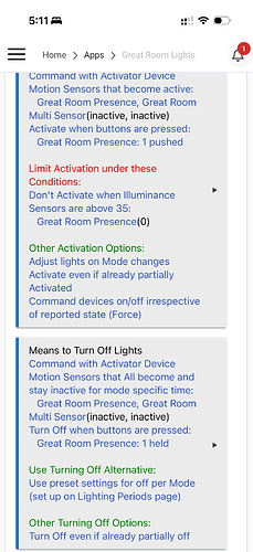

Have you tried adding Activate When Mode Changes in the means to activate?
That’s a good idea, I’ll try adding that to the activation. I thought the “Adjust lights on mode changes” would have applied to both with the lights on and off, but it doesn’t seem that’s the case.

It does, but only if the Room Lighting instance is active. If Room Lighting is off (not the lights but Room Lighting itself), then nothing happens. If Room Lighting is active due to motion, button press, or the activator being turned on, then your lights would change due to “adjust lights with mode change” option being selected.

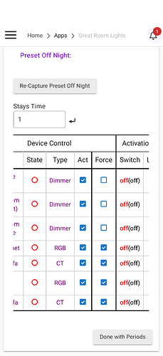

So this may not work for me. During evening mode, I have definitions with lights on to different degrees for On and Off by using the Preset Off per mode settings.
Is there any way to trigger the different Preset Off modes when the mode changes?

Not really. The options are not graceful and will counteract if Room Lighting is already active. It also depends on how you are using the Activator device.

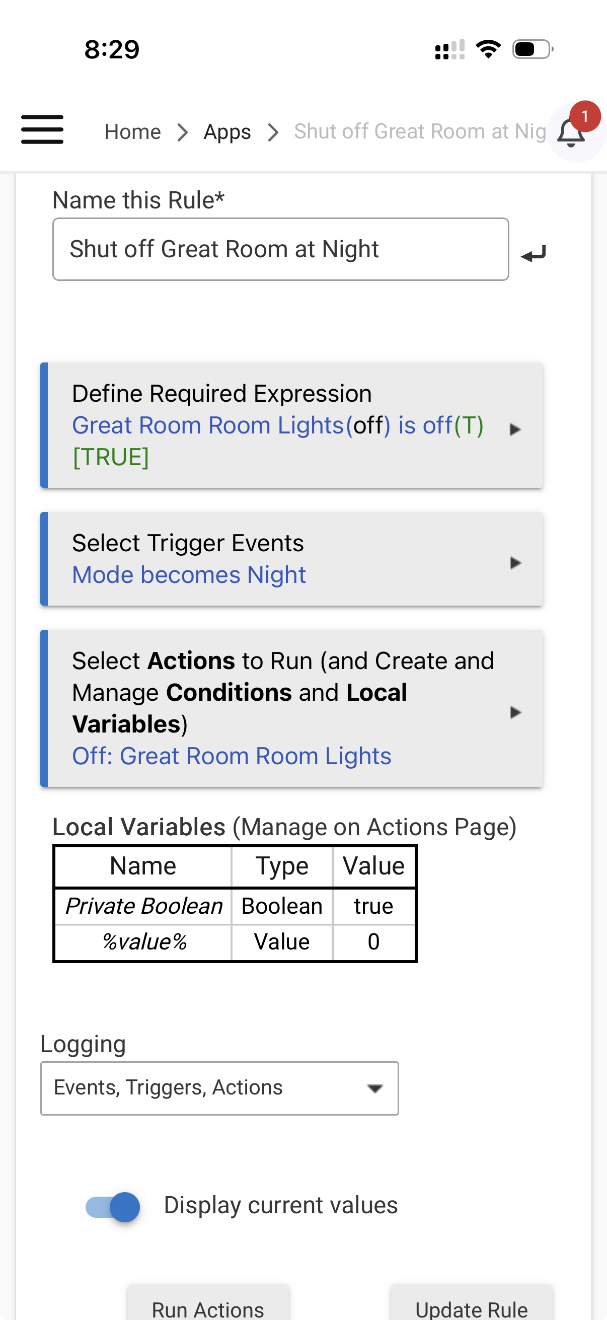

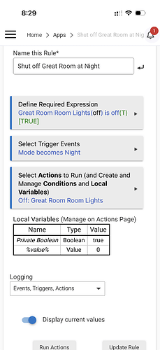

I’m going to try creating another rule that will trigger the off action when going into night mode if the room lights are off.
That setup doesn't make sense, since the end-state of the Action is the Req'd Expression for the rule itself...
Is the Req'd Expression perhaps supposed to be On instead of Off?
It's an odd way of doing things, but would potentially meet the OP's goals. Basically, they are trying to hack Room Lighting's Preset OFF functions even if Room Lighting is not currently active to move the lights into a different Preset OFF when the mode changes. It's a little confusing but the general idea is:
1.) Room Lighting is not currently active. So, lights are in a Preset OFF state for the current Mode.
2.) Mode changes to Night. Now, the lights are in their Preset OFF state for the wrong Mode (evening or whatever the OP is calling it).
3.) With the Rule above, the OP can shift the lights to the new Preset OFF for Mode = Night because of the uniqueness of the Activator Device and the "Turn off even if Partially Off" option in Room Lighting. Basically, a RL's Activator Device can be "turned on" even if already on and "turned off" even if already off. So, with the Rule in place, it would shift the Preset OFF to the new Mode based on how it is written.
@cody, one thing you will need to be aware of is that this will turn off your lights if Room Lighting is Active but the Activator Device is Off. Say you have motion that turned on the RL instance, if the Activator Device is not in sync (i.e. Activator is OFF but RL is Active), your rule will trigger with the Mode changing to Night. You might want to think about adding a guard for the motion sensors into the rule as well too. In the actions you could write:
