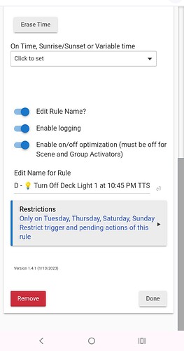

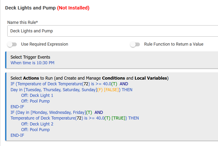

Deck light 1 turns off on Tuesday, Thursday, Saturday and Sunday at 10:30 pm
Deck light 2 turns off on Monday, Wednesday and Friday at 10:30 pm
I'd like to keep them on ( and the pool pump ) if if the temperature is below 40⁰

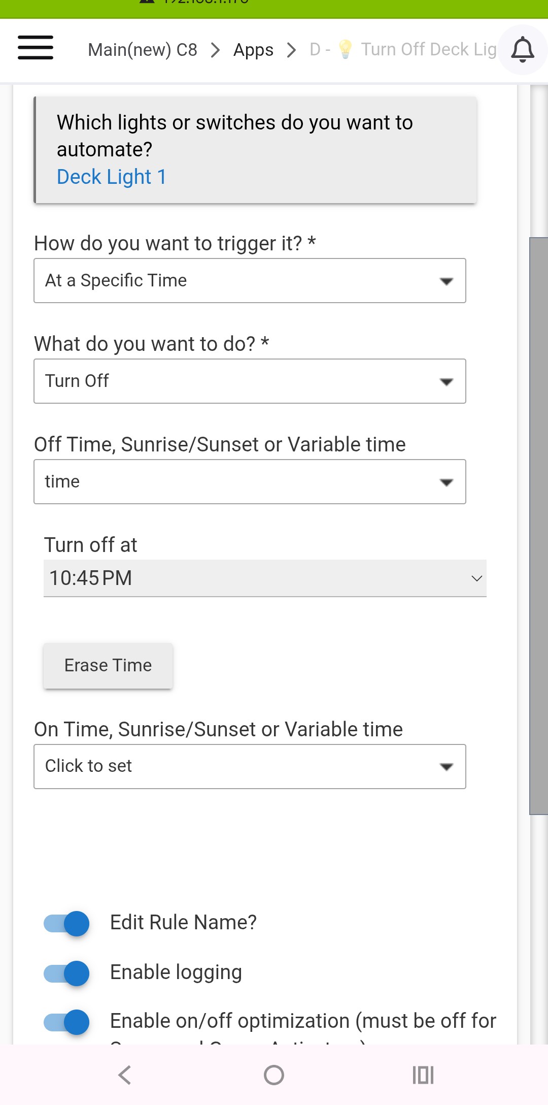

The switch stops working. One is in the garage and when the rule runs the light doesn't turn on. If I turn on the switch the light comes on.

I think it could be a fairly simple rule machine rule to do all of this...
