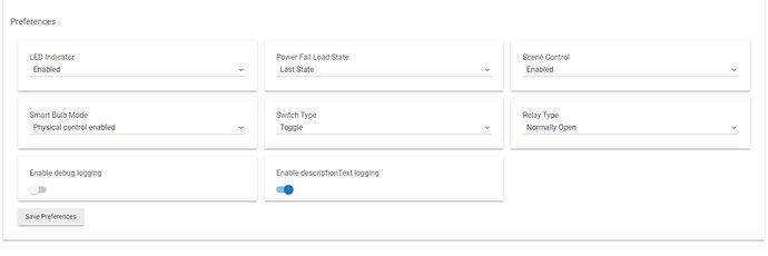

Can you take a screenshot of your settings page for me, for comparison, please?

Will get some some pics when I get back home but your settings look correct. You have to have the latest version of the relay. I had an older version and it wouldn’t work.
I can turn the light on or off from either 3 way switch just as if the relay wasn’t there. And if I turn the light on or off from HE then I still only need one switch movement to do the opposite. I don’t have to do a toggle on and off again. Everything works just as intended.
Make sure you are using the Zooz zen51 relay advanced driver. You can download that from Thesmartesthouse website.
That did it. I never would have known to switch to that. Thank you very much!
