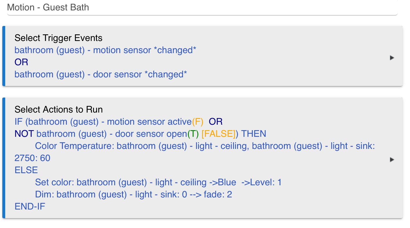

I’ve been heading down that same path but don’t have all the pieces in place yet. One bathroom has a motion and contact sensor and the other has a motion sensor and Pico remote. I don’t have all three devices in either as yet.
The motion/contact rule is pretty simple.
If the door is open then the motion sensor works as expected. If the door is closed then the light stays on regardless of the state of the motion sensor.

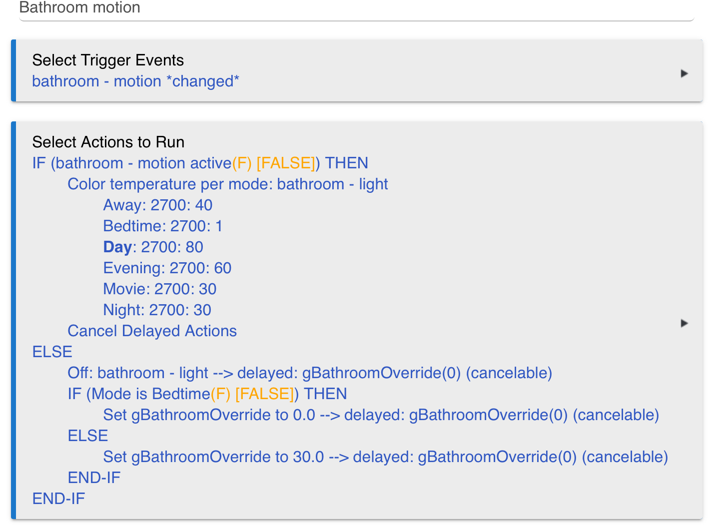

The other bathroom is more complex and uses a global variable.
Currently it is only managing the motion events until I get another contact sensor.
I’m using an Iris v2 sensor so the sensor goes inactive after 30 seconds no motion. I also have a global variable (gBathroomOverride) that is used to delay turning off the light.
When the mode is "bedtime" the global is set to 0, otherwise it is set to 30. This way at night the light is on for only 30 seconds after motion stops. All other times it stays on for 60 seconds.

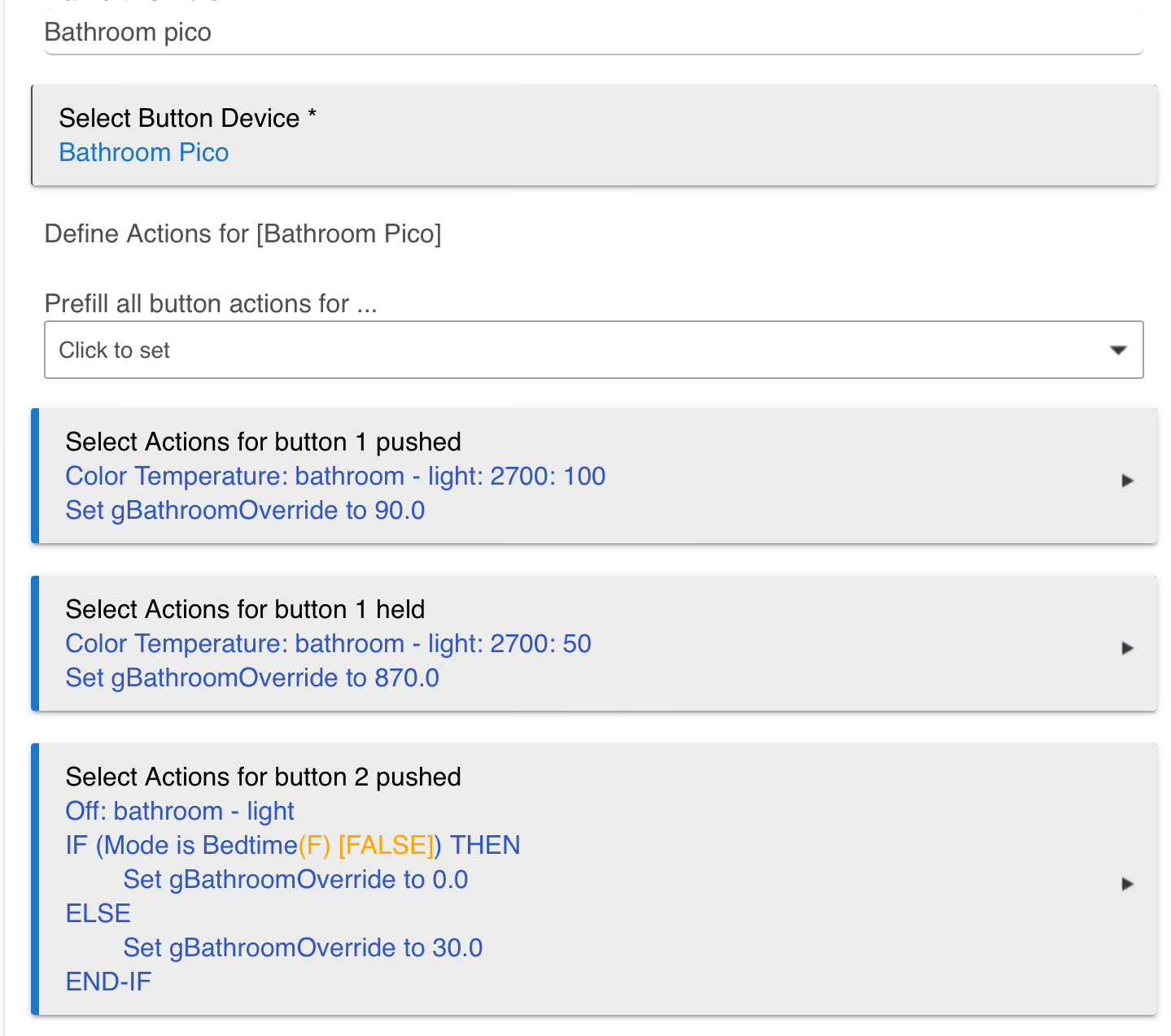

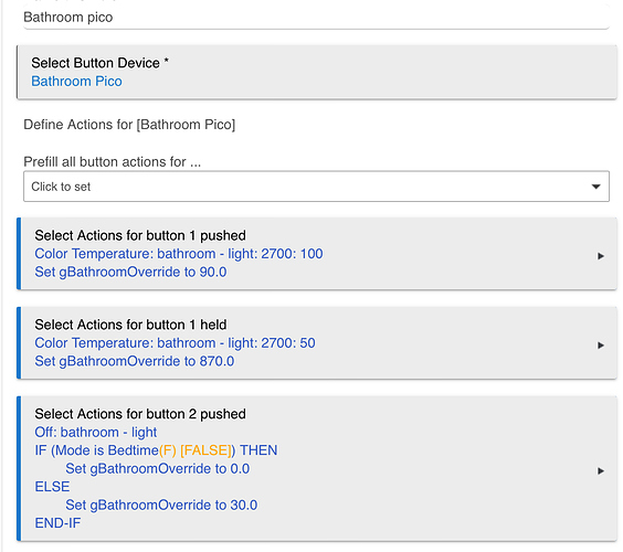

It works well but you may be wondering why I used a variable as it would be easier to just set the delay in the commands. That’s where the Pico comes in.
If you press the on button it sets the light to 100% and changes the delay to 90 so the light will stay on for two minutes after motion stops. This gives you a longer window to re-trip the light. Likewise if you long press the on button it will set the level to 50% and the delay to 870 for a 15 minute delay (bathtub setting).
If you press the off button it will immediately turn off the light and reset the delay to 0 or 30 depending on mode. Obviously you don’t really need the off button but the switch is mostly there so guests have a familiar UI.

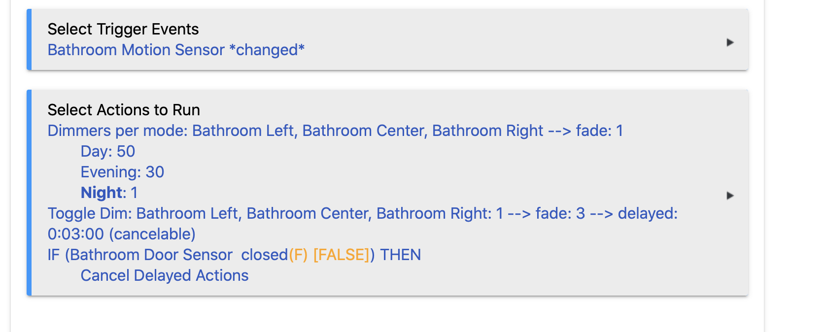

I have a contact sensor, and the problem I'm having is overriding the delay and having the contact sensor keep the lights on until the door is open again.
This is what I'm trying next: (Edit: It didn't work.)

Screen Shot 2020-04-12 at 3.47.42 AM|690x469 !
First off you are running the rule when motion changes but you are not checking the condition. So when motion is detected it will turn on the lights and when motion stops it will turn on the lights.
