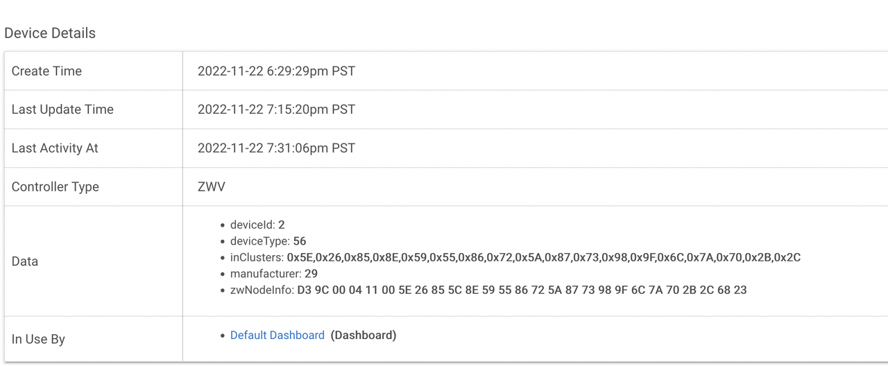

Preference section of the Device page: Image link

First off, sorry I forgot to welcome you to the Hubitat forums yesterday, and tell you that if you would like to post pictures natively on the forums, you can join the Owners group. But it looks like your permissions got updated automatically at some point, so you should be good to post pictures now.
Now I have a few more questions.
  • This issue of turning on at the wrong speeds is only when you use On?
  • If you use the L/M/H (or in your case maybe just medium & high) test settings in that top section of the Device page, what happens, do the speeds work correctly?
  • Do the "States" in the upper right corner of the Device page reflect what speed you command from the Device page (again using L/M/H)?
  • Similarly, what do the "States" do when you use the physical switch, do they reflect the actual button presses?
  • Did you try hitting "Configure" to pull in the device capabilities to the hub?
