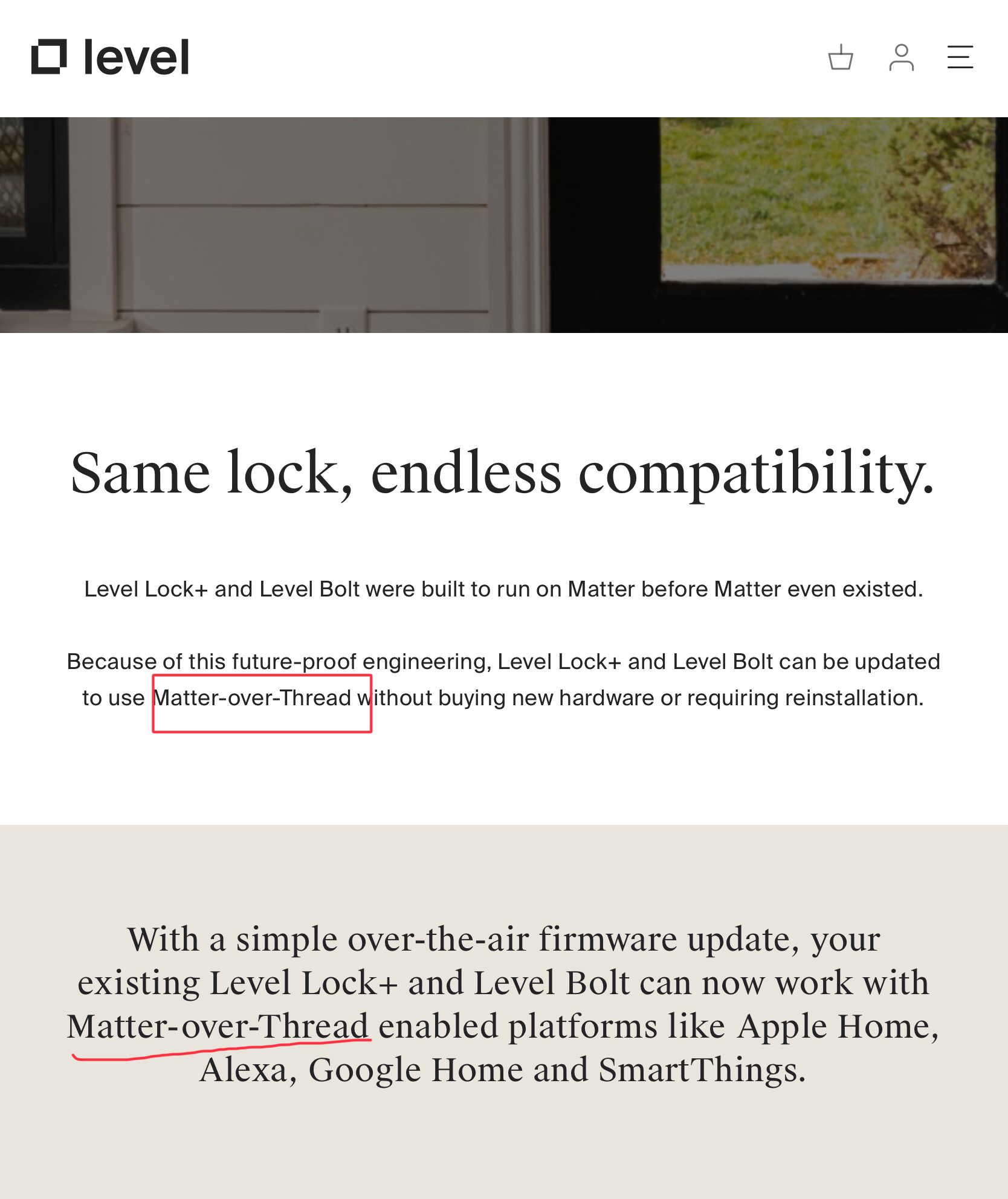

It appears that the Level Locks are Matter over Thread devices. As such, yes you will need to pair these first with another system that supports Thread Border Router (TBR) functionality. This requires an always-on hardware device, like an Apple HomePod Mini, that includes a Thread Radio that can be used as a TBR. Once the Level Lock is paired with Apple Home, Google Home, or Amazon Alexa (using one of those platform’s hardware TBR equipped devices), it can then be shared via Matter to the Hubitat hub.
If the Level Lock was a Matter over WiFi device, it could be paired directly to Hubitat. but since the Hubitat hub does not contain a Thread radio, it has to depend on a third party Thread Border Router (TBR) device.
Correct as @ogiewon describes. A thread border router is required and from there you can share it with Hubitat. In my case I have a TBR on Home Assistant and shared it with HE via Matter integration. In previous versions there wasn’t a matter lock driver so things didn’t work correctly so I had to use HADB and created a lock driver.
