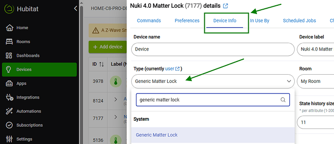

Change the driver (the device 'Type') to 'Generic Matter Lock.'
