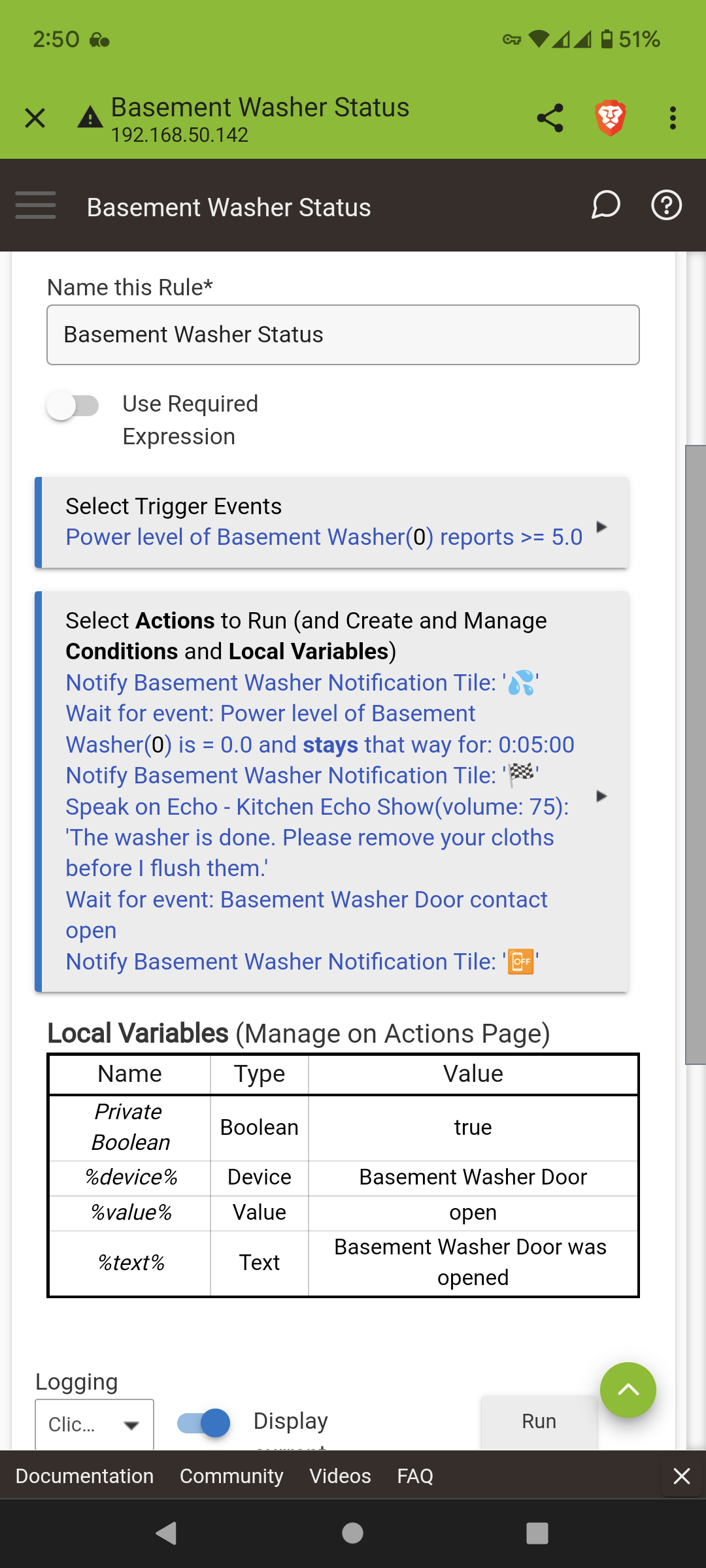

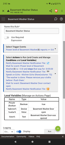

I'll go first. This one I have to admit I stumbled on by accident by fat fingering my phones keyboard for a notification message. This is using the @jpage4500 dashboard. I wanted to be able to get better notifications for my laundry machines. The problem I had is I couldn't find icons that I liked that made sense for the various stages. So instead of using device icons I created a rule in rule machine using a mobile presence device which allows for notifications in my dashboard. That tile accepts emojis from my phone. Phones have a huge readily available database of icons.
Washing Machine: just needs power monitoring plug, a contact sensor, and mobile presence tile. Here's a picture of the rule including the notification that shows on my dashboard.

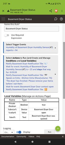

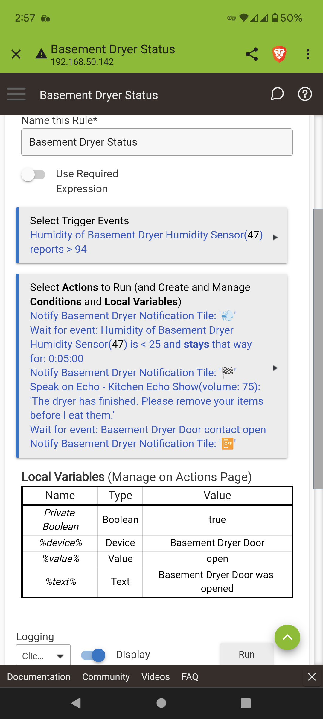

The Dryer: Here I used a Sonoff temp/Humidity sensor and slapped it right on the inside of the door with the wet hot cloths (Don't do this, put it in the dryer vent so it's cooler). I will say it is still working after dozens of loads, though I admit the temp portion doesn't report anymore. Than we need that mobile presence tile for notifications and another contact sensor. Here's the pic of the rule.

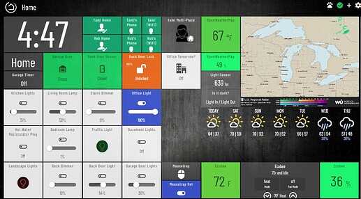

Not too unconventional, but I use a virtual attribute set to write formatted time in large HH:MM format to a tile on my dashboard. No seconds or date like a normal clock. I have a webCoRE piston that writes to it every minute.
I actually have a few of those to display custom information... Garage door auto close timer (closes automatically 8 minutes after we get home, but only if it was closed and opened automatically), Light inside/outside indicator (based on illuminance threshold from sensor in a skylight)...
