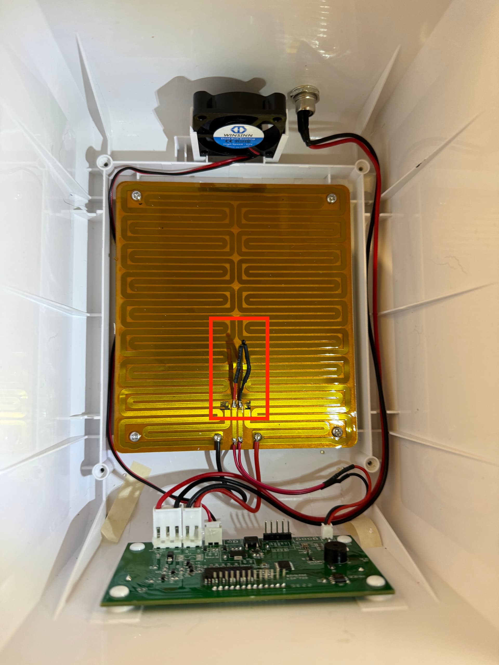

Btw, I've changed the Dryer instructions to allow for use up to 50c.
https://www.printables.com/model/575370-sovol-dual-spool-filament-dryer-temperature-accura

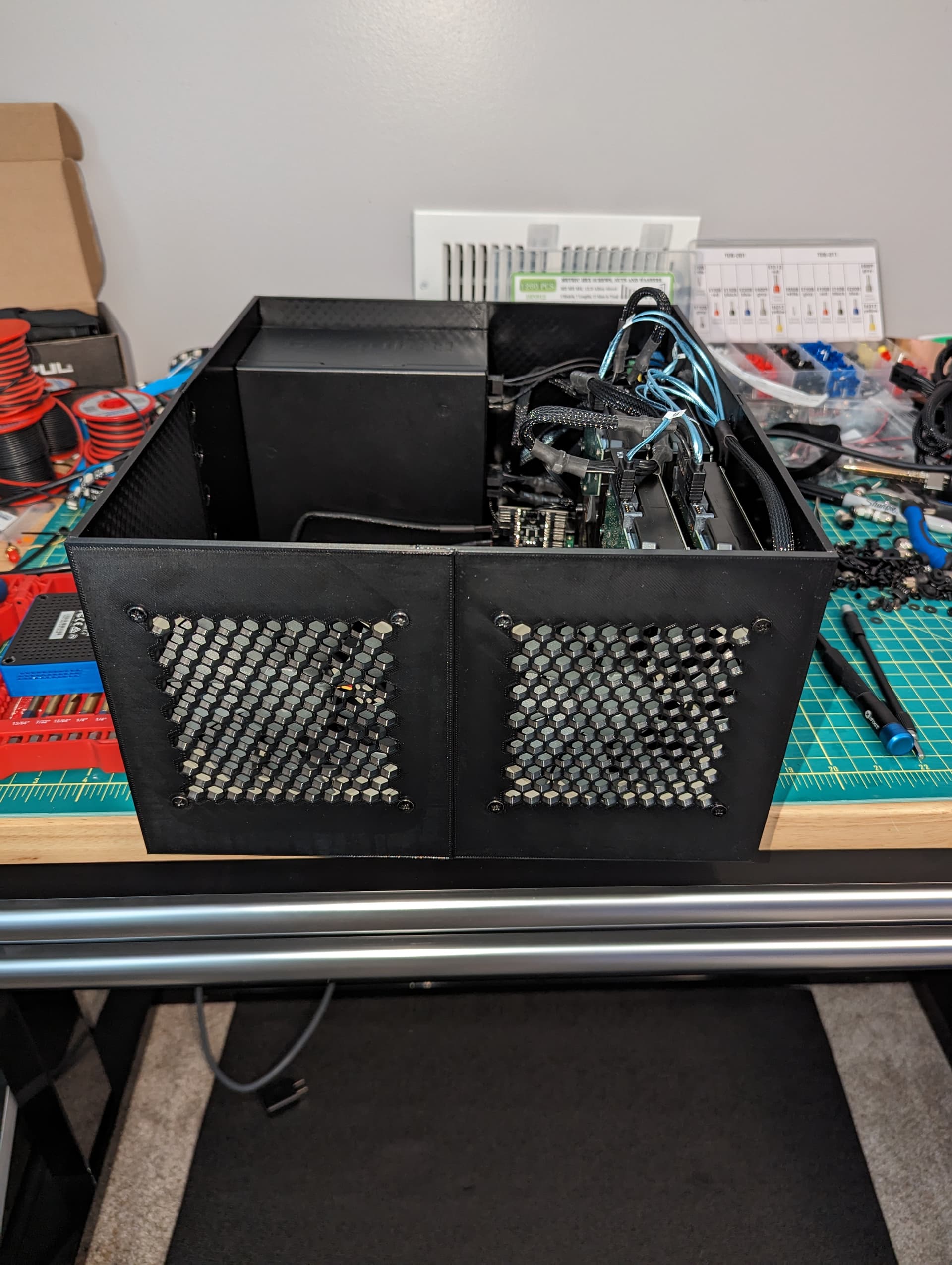

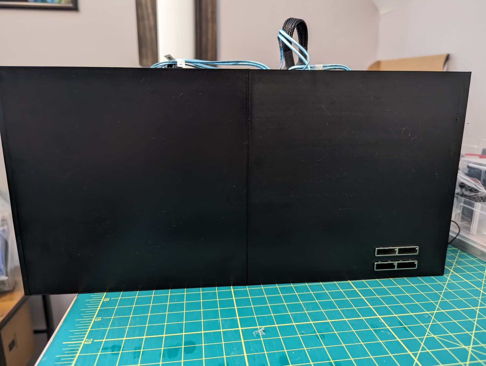

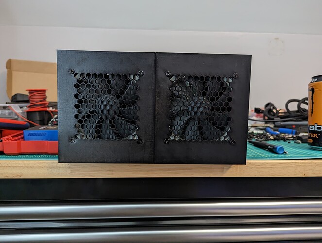

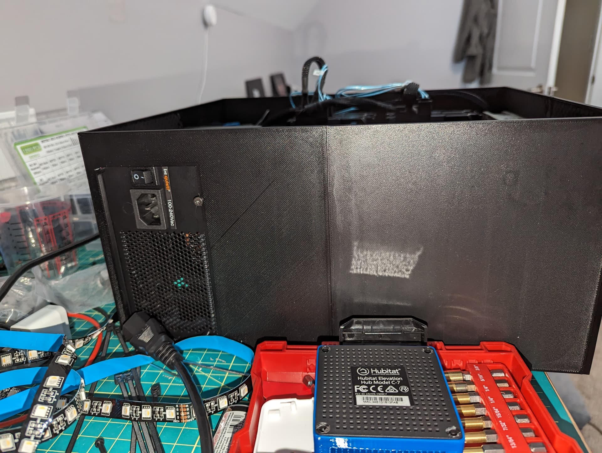

I started beefing up the storage for my Plex server a few months ago. My home server is built in a random mid-size tower case I had laying around. After getting to 4 3.5" drive, I ran out of physical space to add anymore drives.
This led to wanting to build a JBOD enclosure. For some reason though, they’re all relatively expensive for what equates to a metal box.
So, I instead decided to 3D print one with plenty of space for expansion. I landed on designing it around using a standard ATX PSU, 16 3.5" drives, four 120mm fans for cooling, and space for SFF-8087 to SFF-8088 converter cards.
Designing the case was fairly straight forward, albeit pretty time consuming. The real challenge though was breaking it into parts that would fit on the print beds of my Bambu X1s. I ended up using mortise and tenon style joinery to interlock the bottoms and sides along with half-laps with dowel style joints to join the side panels together.
I was finally able to get it together enough to be used and put it into service today. I’m using an ESP based relay to turn the PSU on with the ESP being powered by the standby 5V pin off the PSU. The drives are connected to the converter card with an SFF-8087 to SATA cable. The drive connection is carried to the server through an SFF-8088 cable and a PCIE LSI HBA card.
I still have to print the lid and make some tweaks to the 3D model before doing a more extensive writeup and posting the model to Printables.
Clean case design! What material did you print with? I would think PLA would be ok with the cooling you have, but you could possibly see some sagging or warping in the panels over time with a sustained thermal load (especially with 16 active drives). Might be worth adding some support beams into the top cover rather than just a flat plate, but I assume you have thought about all of that already :grinning:

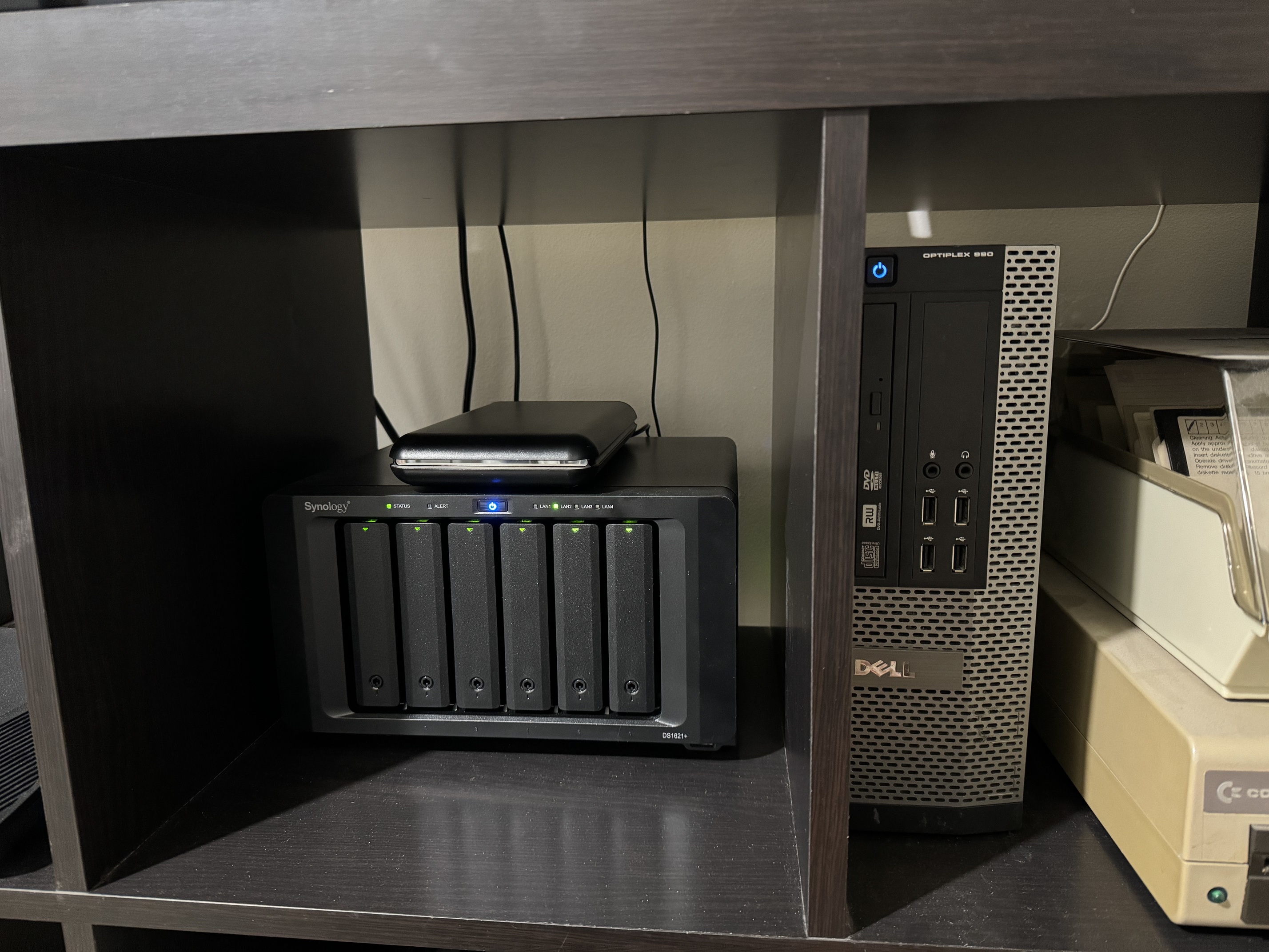

Nice! I just replaced two HP MicroServer’s and 2 small NAS’s with 1 big NAS, a DS1621+. The thing is a beast with it's 4 core 8 thread Ryzen CPU.
I thought about making a custom server again (I used to run OMV), but I just couldn't be bothered.
PS, I have a dedicated Plex Server (the Dell SFF PC) with Nvidia Quadro video card and the NAS hosts the files.

Dont bother with the little ARM powered ones, they are missing all the useful stuff. Grab something with a Ryzen CPU as they actually have enough grunt to be useful, including support for BTRFS Snapshots, NVME SSD Volumes, ECC Ram and so on. The only intel ones that come with ECC support are their overpriced Xeon powered units.
I used PETG. The cooling probably would have been enough to use PLA except for the slots for the drives since it's a friction fit to hold them in place. I actually tested using dovetails, but the layout of the rest of the model wasn't conducive to using them.

I made the mod today. After a 3-hr test run without a spool, it registered 50c/19%.
I did it without soldering or shrink tube. I had noticed a small, rectangular well in the roller base plate. After cutting the thermistor off the heater board, I removed the well's bottom, added some side vent holes to the small compartment, and fished the thermistor assembly up into it as I reassembled the base plate. Worked!!
