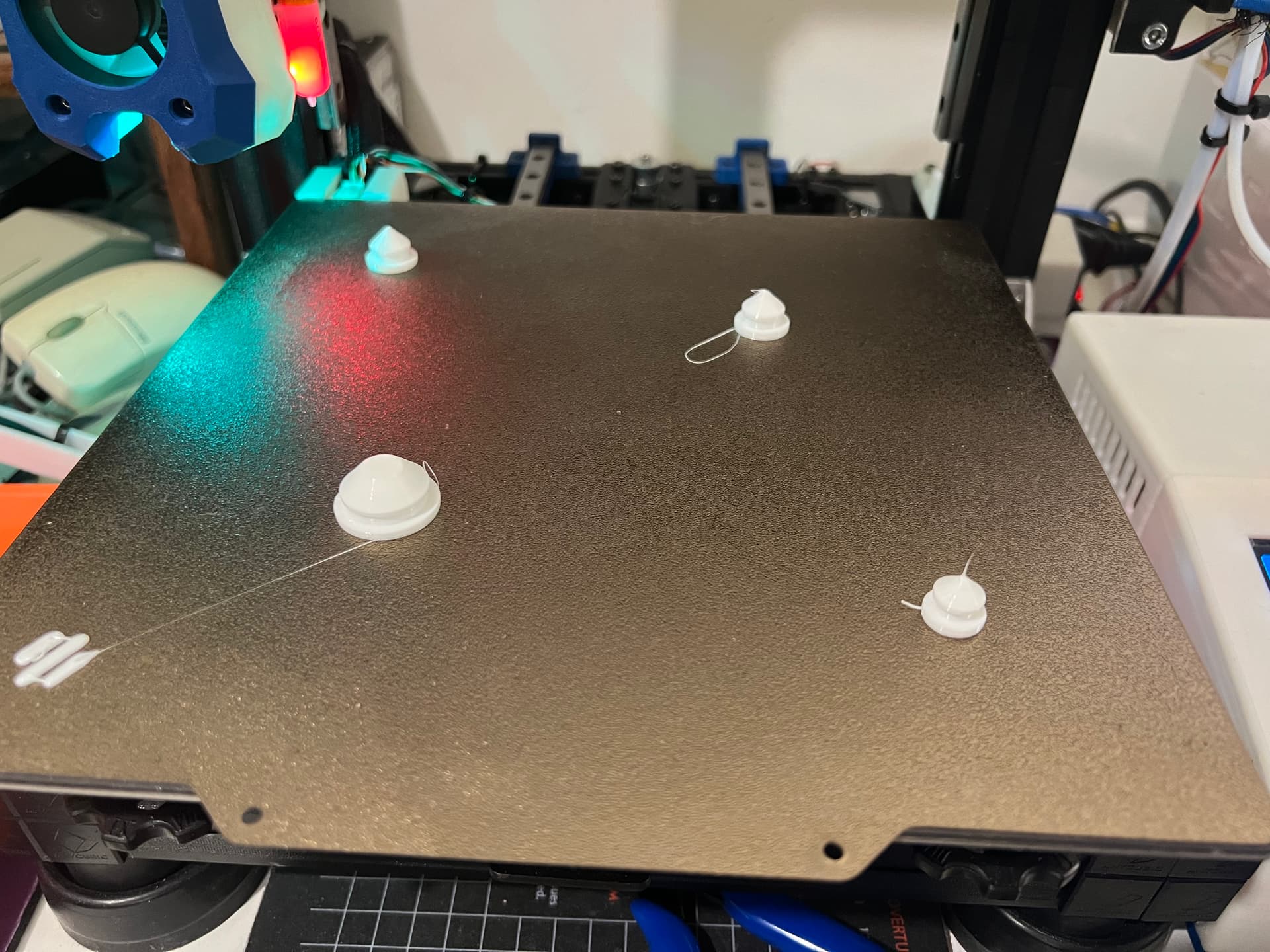

Cold! Wow, I hadn't looked at any TPU printing guides...had no idea you'd have to go that low.
Some TPU even says no bed heating. I took the advice from a tuning guru after struggling to remove the parts from the bed.
Sequential putting turned out great and 2 of the 3 designs worked too. I’m just printing some tweaks to the 3rd plug.

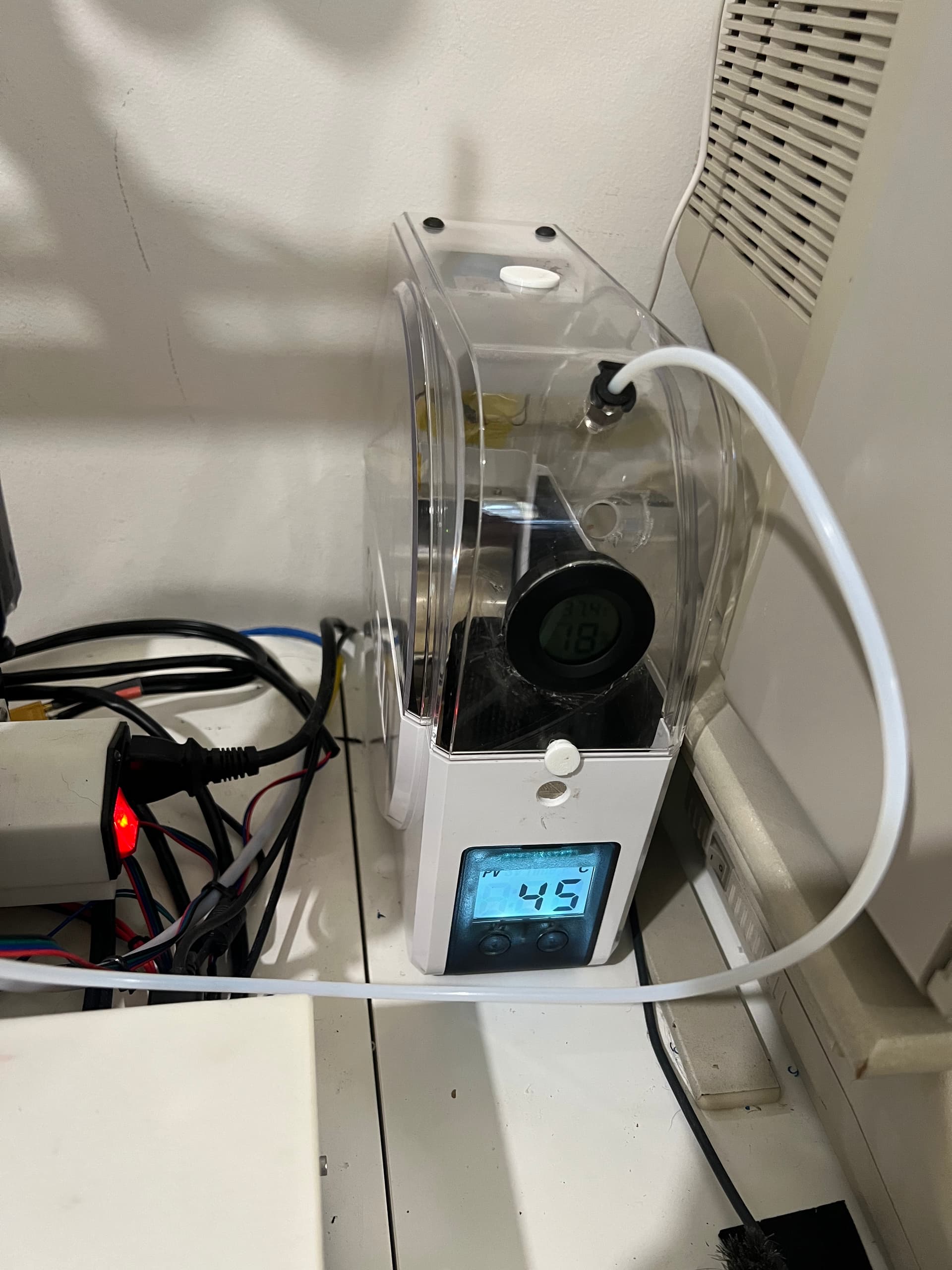

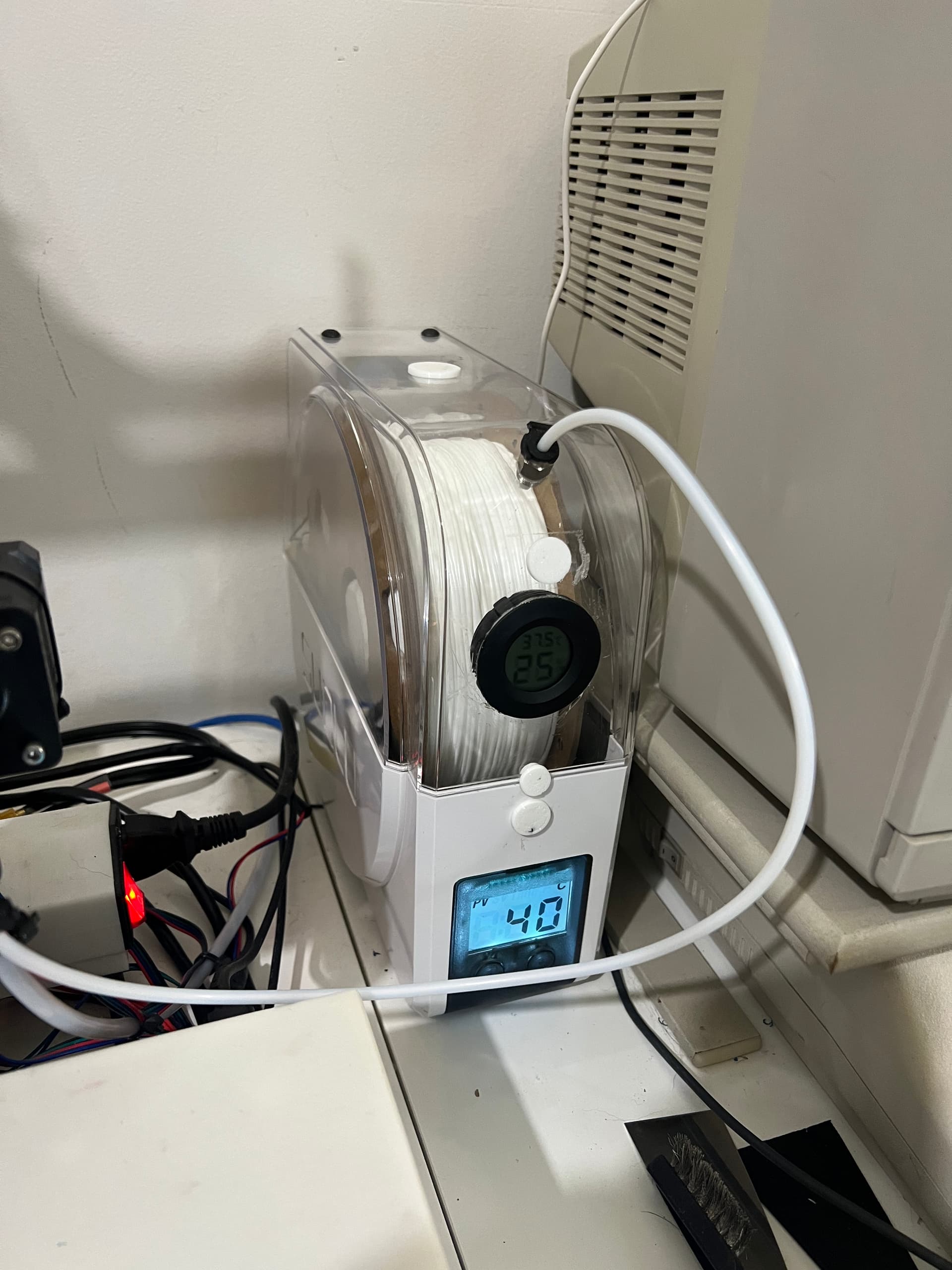

I made some plugs to fill the holes I made in my Filament dryer.
