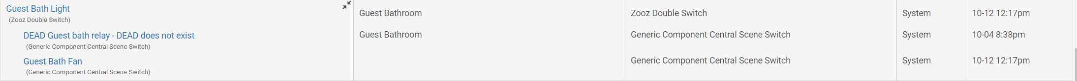

Had a ZEN30 get fried last week by an electrician who blew the breaker on the relay circuit for the fan switch. Today I noticed this (I have renamed it to add DEAD):
That would be the child device for the old ZEN30 that this new one replaced. As you can see it hasn't been active since last week. I did remove the ZEN30 but somehow I have this left over. :man_shrugging:
Can I get rid of just that child somehow? Doesn't seem to hurt anything it's just weird. I can rename it so it's always at the bottom of my devices list but I'd rather remove it.

Not sure it matters as it's not the child that repeats but the parent so as long as the parent is alive you shouldn't have an issue. You can try to change to the DEVICE drive, click save then click delete everything then switch back to the normal driver, click save then configure and that should clean things out.

See above. Change the driver to device. Click save. Click all the delete buttons for state and what not. Change back to the main driver. Click save, click configure.
And now the correct child is also gone.... sigh... now I have no fan control.
When you put the driver back and click configure it should come back (make sure you pick multi endpoint)
Did that and now I have this and neither child will control the fan so it's worse now than it was....
I guess I can repeat the process again. Nothing to lose at this point. Just so many rules on this switch that I don't want to have to edit if I have to remove it and put it back.
Worked when I did it again! Whew! Thanks!
