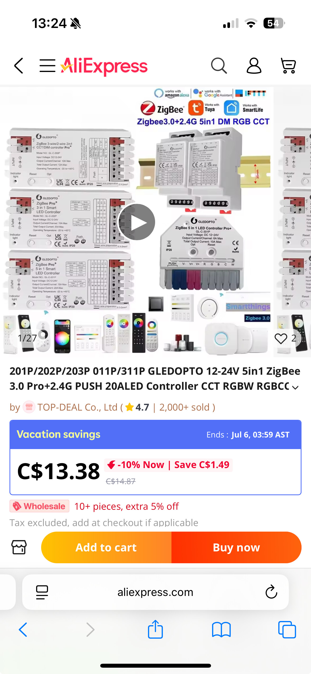

You’ll need a controller like this one:
And also a power supply of 5v, 12v or 24v depending on what your LED Strip requires.
Ali express is typically cheaper, Amazon will typically ship faster and has better return options.
The controller you get should have the correct type of connection, 2 for white, 3 for CCT, 4 for RGB, 5 for RGB-W or 6 for RGB-CCT.
