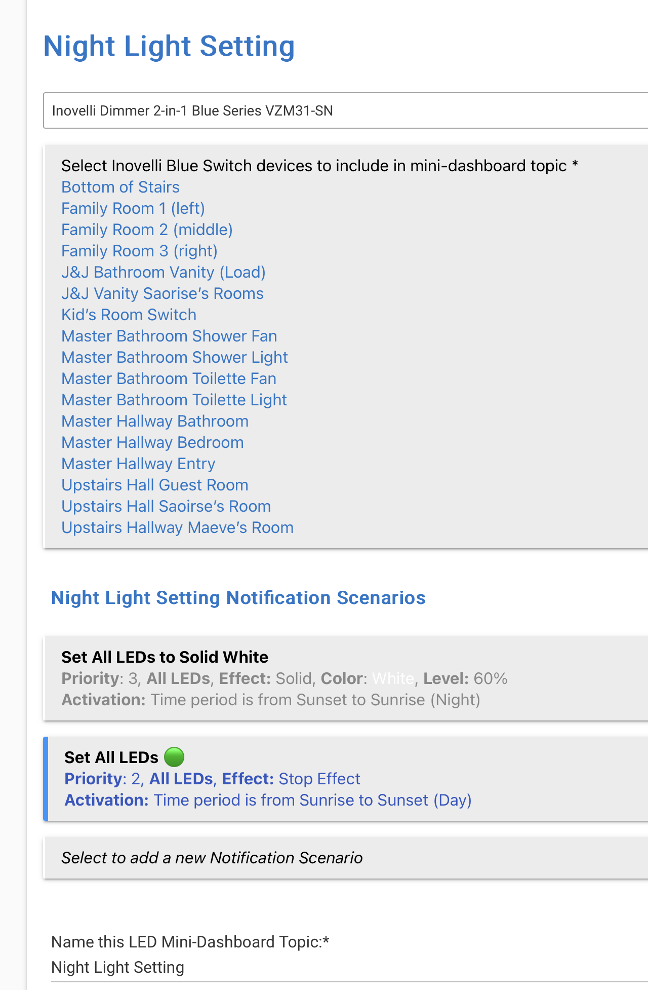

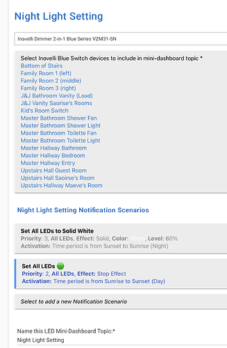

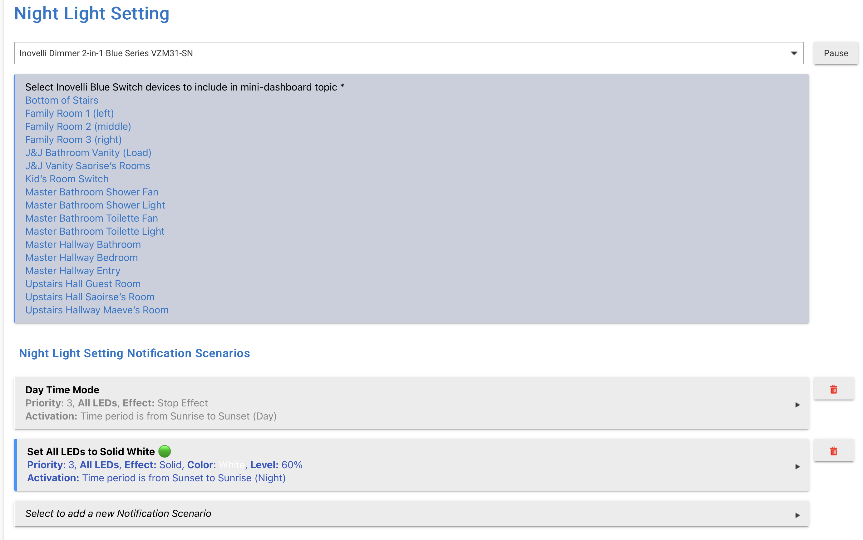

has anybody built a workflow based on sunrise/sunset? If so any recommendations? thanks!
What are you looking to do?
I suspect that the 2nd scenario (Stop Effect) is not necessary. The LEDs should turn off automatically when the first one reaches its end.
Try removing that 2nd one first and see if it makes a difference…
Thanks. I’ll try that and let you know tomorrow.
so far, sunrise has come and they didn't turn off, any suggestions to figure out why?
I would start by enabling debug logging. That would help pinpoint what is happening. Then post a screenshot of the resulting logs for that app.
I deleted the rule, put it back - noticed a green dot this time next to the active portion and now it appears to be working
Well that’s good! I don’t have any green dots next to any of mine, so not sure what its significance might be…
IIRC, the green dot indicates the currently-active option in cases when you have more than one (such as time-period based options, like this example).
But it's been a while since I've used this app, so my memory may be off!
I also seem to recall that it wasn't always consistent -- I remember sometimes seeing the green dot active (in expected circumstances), but other times not... Overall, the setups otherwise worked fine for me, so I didn't bother sweating that green-dot detail much.

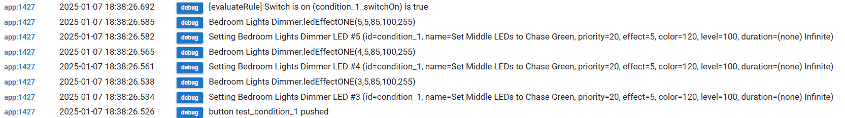

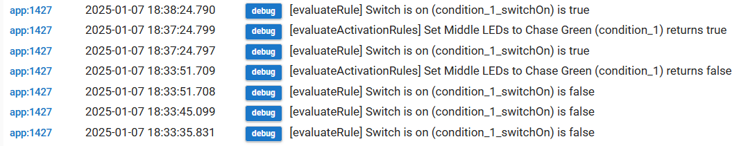

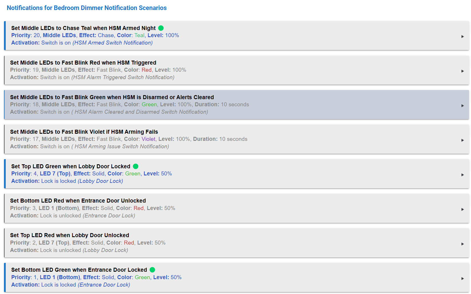

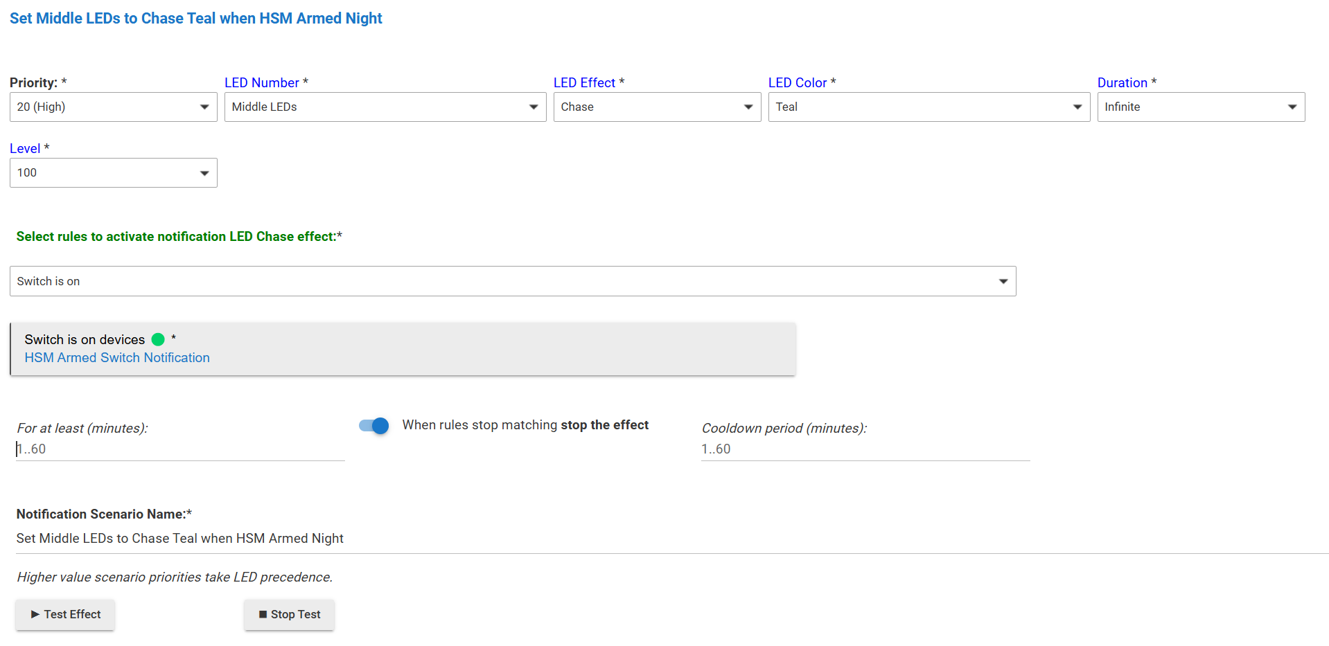

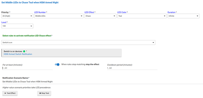

Any pointers guys, Im getting the green dots which show my rules are triggering, but Im not getting all the output on the switch (VZW31-SN); the rules that work on LED 1 & 7 are fine, but all of the ones for the "middle LEDs" dont work:
Funny thing is, when I hit the "Test Effect" button it works as expected. I'm trying to use the top and bottom LEDs to show the state of my 2 locks, and the middle section for HSM alerts:
Here are the logs from the tests when arming/disarming HSM

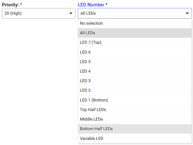

There is no discrete way to call the top or bottom half -- the 2 available LED-management options are "setAll" (LEDs) or "setOne" (LED).
So to set the top or bottom half (or any combination of one or more LEDs that isn't all of them), you just use one or more "setOne" commands for the LEDs you want involved. For ex, LEDs 7-5 are upper ones, 4 is the middle one, and 3-1 are the bottom 3.

Here is the test rule set up to trigger the middle section chase notification, and you can see it shows as active by the green dot once I turn on the virtual test switch:

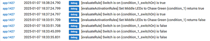

Here are the logs from when I triggered that rule from the switch:
At this point nothing happened on the switch.

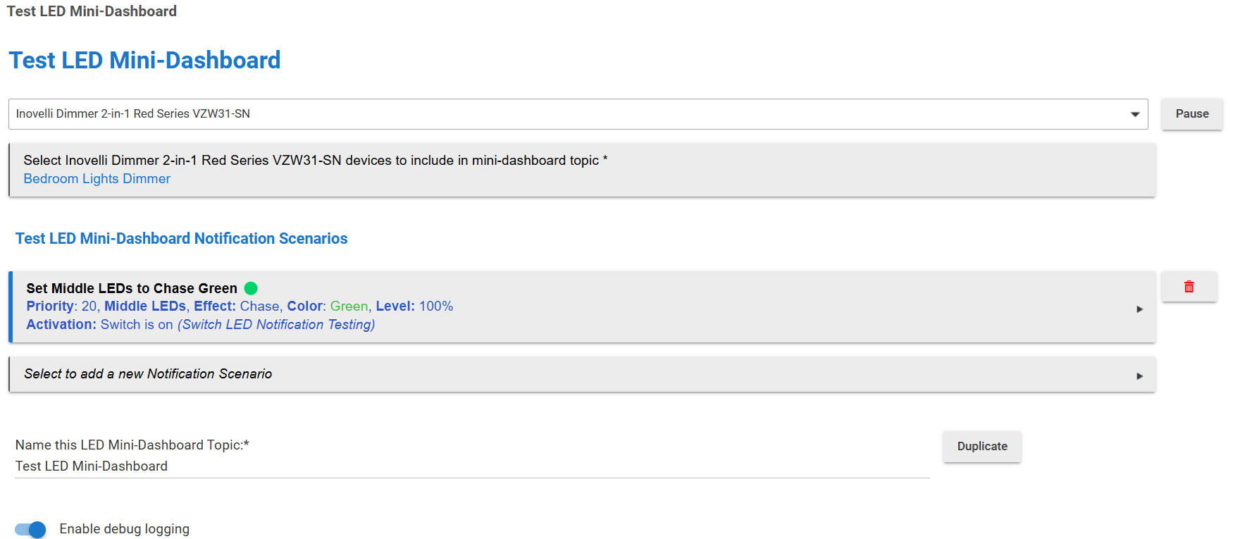

Here are the logs from when I hit the "Test Effect" button where you can see its actually setting the LED conditions:
And the output works as expected on the switch as you can see in this video:
I appreciate that video -- thank you -- that at least confirms that the Chase effect is possible with just a few LEDs (i.e. not restricted to using all of them).
