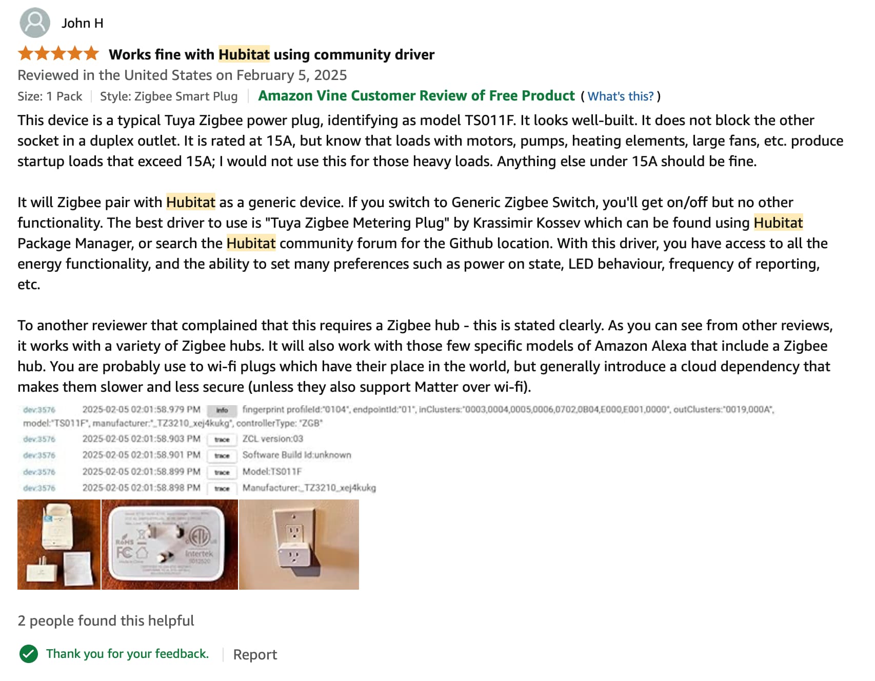

It was mentioned in a couple reviews. Here's one of them.
Lots of devices not on Hubitat's compatibility list work fine with Hubitat using either built in generic drivers or a community driver. In the case of the above it works with a community driver. I'd buy those without hesitation. Pop in @kkossev's driver and be happy.

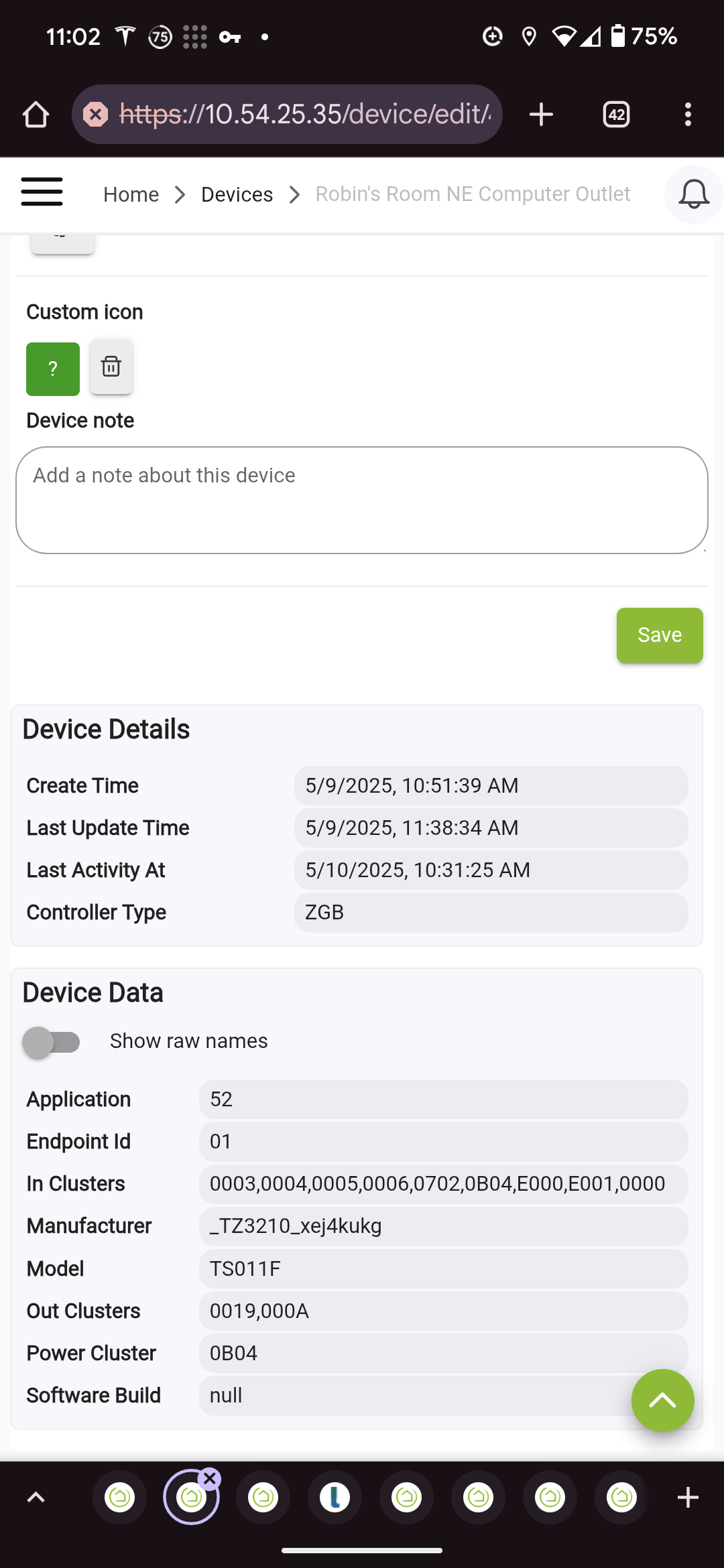

I've got four of the EIGHTREE power monitoring outlets. They work fine with the generic zigbee driver, except watt reading is off by a factor of ten. Shows 10 when it's 100 for example. I've modified my rules to take this into account but would be great if the generic driver has an option for multiple!
Here's the info on it, if the Habitat team @bobbyD would have any desire to add that feature!
