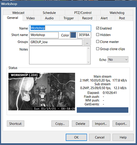

Are you using sub streams within blue iris ? If not you should be, also there is a complete guide of how to lower cpu . Like using sub streams using direct to disk , ect ..
yes, using subs, but it still take a bit more CPU than I wish.

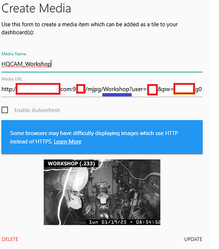

As you said in your other post, you don't need them in HE, just on the dashboards. Blue Iris has a web server function as detailed. In the Blue Iris settings you can get that stream served out as MJPEG without altering the camera at all. You then use the url specified by Blue Iris (at the IP address of the BI PC)

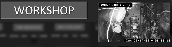

This is live. Click it and it goes fullscreen.
They are media tiles:

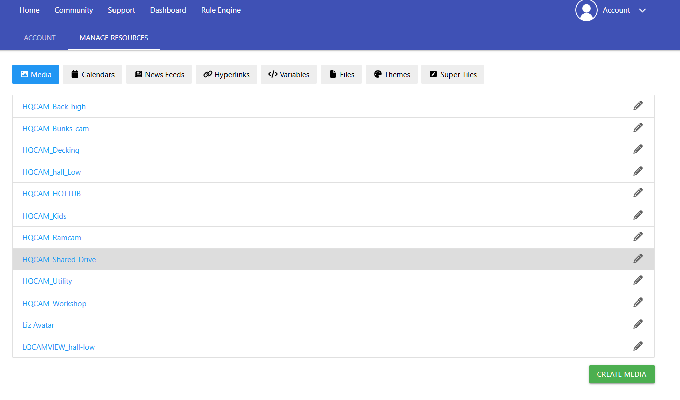

Summary
The info is based on cam names in Blue Iris.
Your camera appears to be accessible externally with a domain name.
I’m assuming that’s necessary for sharptools to serve the camera stream on your dashboard (which goes through the cloud)?
Or I may have misinterpreted one of your screenshots.
Not sure to be honest. My knowledge on all things IT has been badly cobbled together over the years. Stuff works, but Christ knows how.
Have the domain name to access my cctv/blue iris externally.
I'm not sure what would happen if I alter the domain to an ip in sharptools. I presume I'd lose access.
