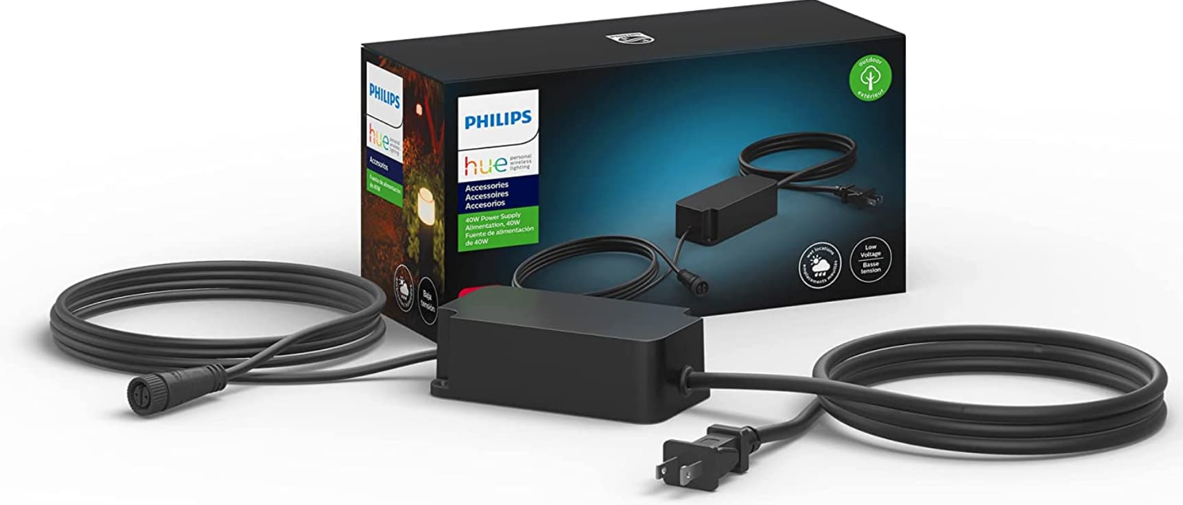

Philips makes a nice 40W one.
Okay now we are talking…I’ll give this a shot…
