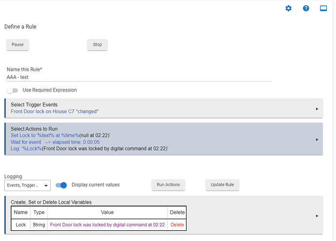

You will need to create a local string variable and set it to device before the wait. Should have mentioned that. If the wait times out, and it will every time, then your device gets set to elapsed time indicating your wait timed out.
Then use the string variable in your notification. I am not sure on Value but I think it should be lock or unlocked.

I never really played around too much with the lock rule. the rule below works for me, I am using %text% however. You said that wasn't be filled in your rule, so that may be a driver issue as I am using the virtual lock. In my rule I only get a notification if a lock is unlocked. I don't care how.
See below but you can trigger on the lock changing, and if a lock code is entered. The %text% variable should get updated, but as I said that may be a driver dependent thing. I am using the generic Zigbee lock driver for my Kwikset 914. When I get home I can test and see what values get filled.
[edit] something else I just realized, I have a Kwikset conversion kit so there are no lock codes to be entered. If your's is the same then lock codes is not an option.
So I just checked my lock, which is a kwickset 914 conversion lock. Using a trigger of changed and filling the variable with %text% the message says if the lock is locked and unlocked and if it was digital or manual. These are the 4 messages I got locking and unlocking via manual and using the dashboard. The rule is below.
Front Door lock was locked by digital command at 02:22
Front Door lock was unlocked by digital command at 02:22
Front Door lock was locked by manual at 02:22
Front Door lock was unlocked by manual at 02:22
