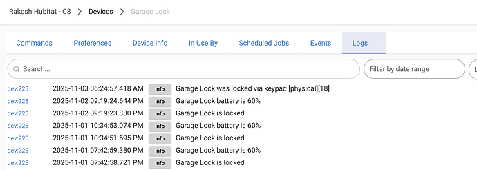

I have a Z-Wave Kwikset lock that has worked flawlessly since I started with home automation (in Wink!). All of a sudden (past 2 days), it has stopped sending events to HE - I can see the entry in the log, but no event is sent and nothing is activated in my Node-RED automations. It is still reporting battery % and if the command is initiated from Node-RED (see "Garage Lock is locked" on 2025-11-02 at 9:19 PM)

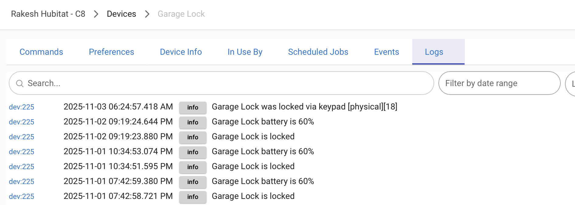

Log entry showing that the door was locked:

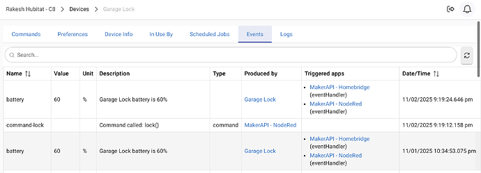

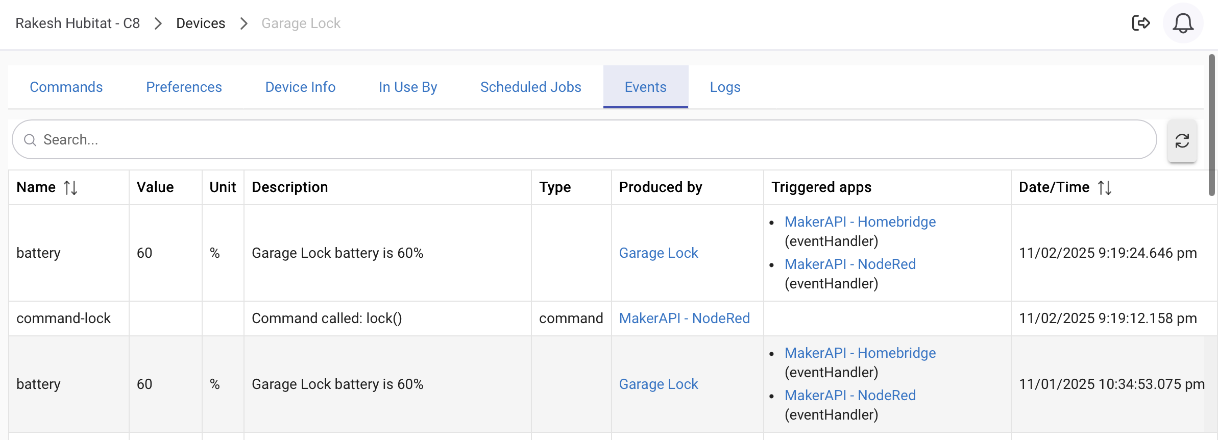

Nothing showing in Events
Z-Wave Details entry for lock - note activity time is right
