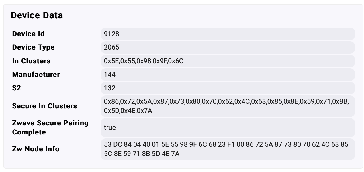

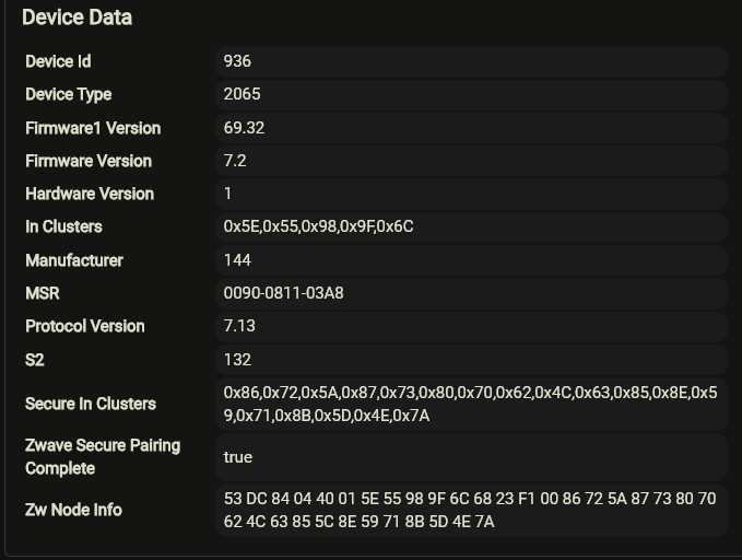

I have 5 Kwikset Home Connect 620 z-wave+ v2 deadbolts. They are all paired using S2. They work fine with the built-in Generic Z-Wave Lock device driver.
This is mine on the newest 700 series and the 500 older ones.

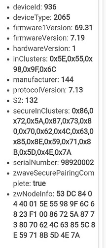

I have a 620 ..
And also does the exact same thing it never used to it seemed like it worked for a long time but just stopped working not sure if it's the hub software or the driver's changed somehow.
Everything works fine updates just fine unless you use the auto lock feature top and above the keypad. Very strange I also think I added it through Smart start..
