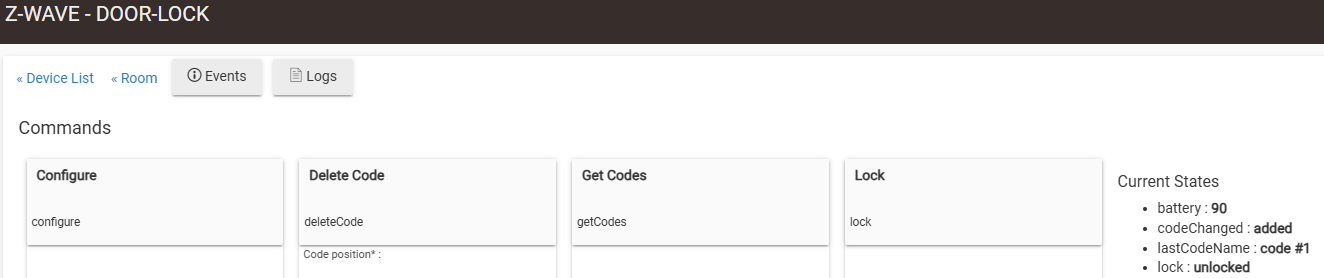

What if you click refresh on the device page?

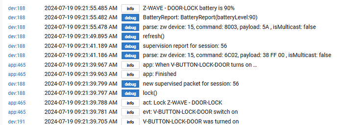

Turn on debug logging and show the logs.

Hmmm Maybe we did .. I tried the button and it does show a refresh .. forgot about that.

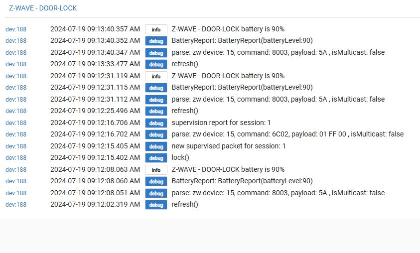

when i hit refresh nothing happens .. well i get a battery report.

Also, capture a debug log when you manually unlock/lock it.
