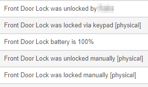

The non-Plus would report its status back after any manual or keypad updates, along with the LastCodeName variable.

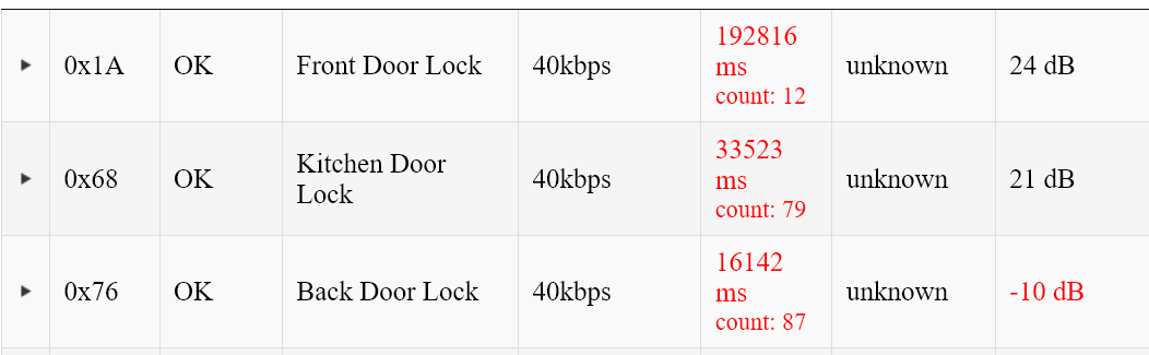

I have 3 of these locks and they are problematic in signal/RTT numbers.
There are Aeotec 6 repeaters nearby but they never use them.
I have a piston running on my network to refresh a few items including all 3 of these locks as they don't update.
