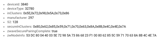

I just received C-8 hub and paired my Kwikset 910 z-wave lock. When listing devices on hub it shows up as a Schlage Schlage FE599/BE369 Lock. Is this expected? If not maybe that is why i cannot add a new user code.
Drivers are auto selected by the hub by matching info the device offers and a DB of values known to the hub. It found a "close enough match" to select that driver. When it does not find a match, it selects the "Device" driver which doesn't do any Z-anything. Try switching the driver (type) to be "Generic Z-Wave Lock" and see how that goes.

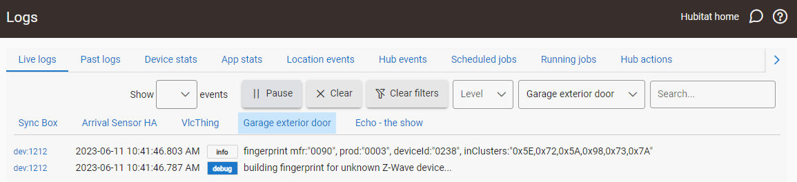

You can swap the driver to "Device" and use the Get Info button to cause Log entries to be output, then swap back to the correct driver.
Logs might look like:
dev:232 2023-04-14 12:29:02.491 PM info fingerprint mfr:"021F", prod:"0003", deviceId:"0085", inClusters:"0x5E,0x86,0x72,0x5A,0x73,0x80,0x71,0x30,0x85,0x59,0x84,0x70"
dev:232 2023-04-14 12:29:02.477 PM debug building fingerprint for unknown Z-Wave device...
(The fingerprint above is for a leak sensor, so useless to you but now you know generally what to look for.)
Get that fingerprint and paste it here and we'll get it sent along so that future users will get a more correct auto selection.

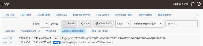

Here is the finger print. Generic driver worked when setting new codes. Lock code manager however does not work with this lock. I noticed a null point reference in the logs for lock code manager(included)

Confirming the same driver match for a kwikset 910 coming up as the schlage fe599/be369. It seems to be working fine including code management.
Here is the fingerprint in case @bcopeland want to add it.
