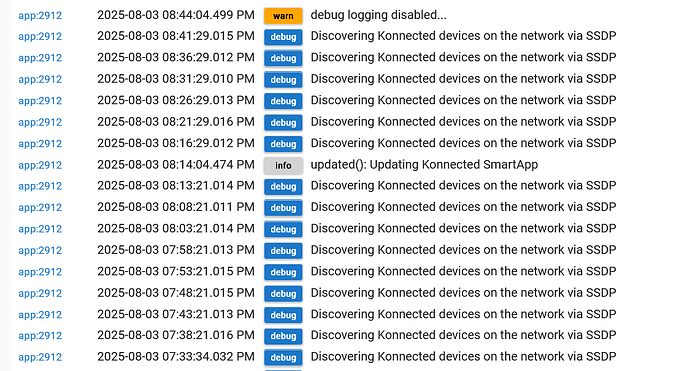

Log of Hubitat Konnected app
Is the hub and the Konnected boards on the same subnet? If I remember correctly both hubitat and the boards need to be on the same IP subnet. I haven't used the Konnected connect app in forever. I flashed my boards through install.Konnected.io to their ESPhome based firmware and haven't had any issues
Looking at your logs they don't show anything out of the ordinary, could you turn on debug logging and post another log

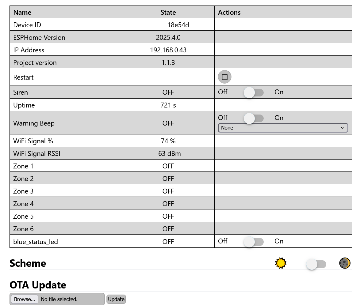

The boards are on the same subnet. I can reach both boards from my browser. The sensors change there as expected....when I open a door, the zone state changes from OFF to ON. But that information is not passed on to Hubitat and that change does not happen when looking at the Hubitat device. This is the browser page of one of the boards...

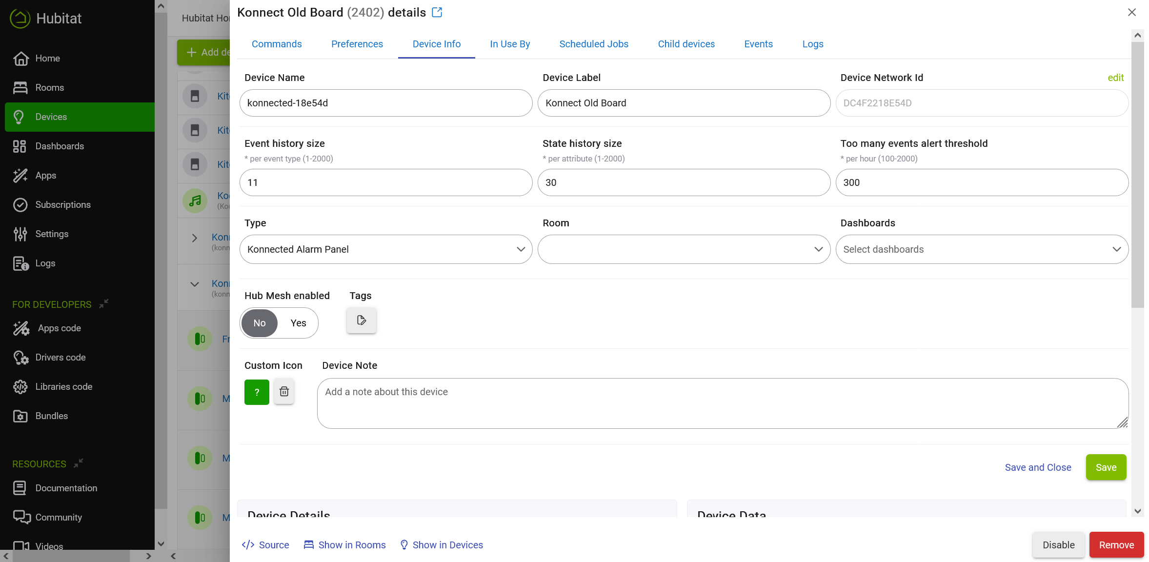

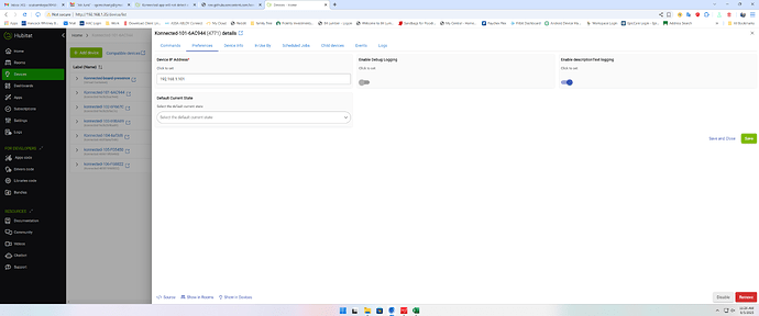

since the zones react I'm assuming it's configured in the Konnected app correctly, so the issue is most likely the Hubitat driver it's trying to use or how it's configured. Here is what my device details and preference tabs look like (you need a virtual device setup for each device with the Konnected Alarm panel driver (link below if you don't have it) once you set up each virtual device on the preference tab put the ip address of that device in your photo 192.168.0.43 (Make sure you setup a Reserved IP address in your router for each device). Click save than go to the commands tab and click initialize. you should see it say online on the right side of the screen (this will periodically disappear even though it's still online, I'm not sure why it does that). If you have all that done already could you post a couple screen shots of your device screens (specifically the device info tab)

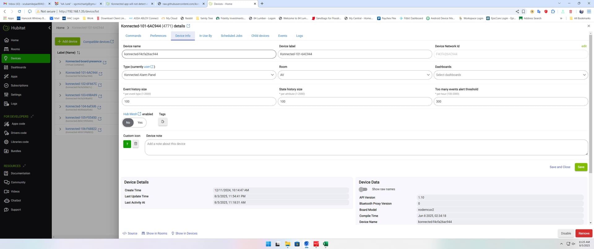

Device Details

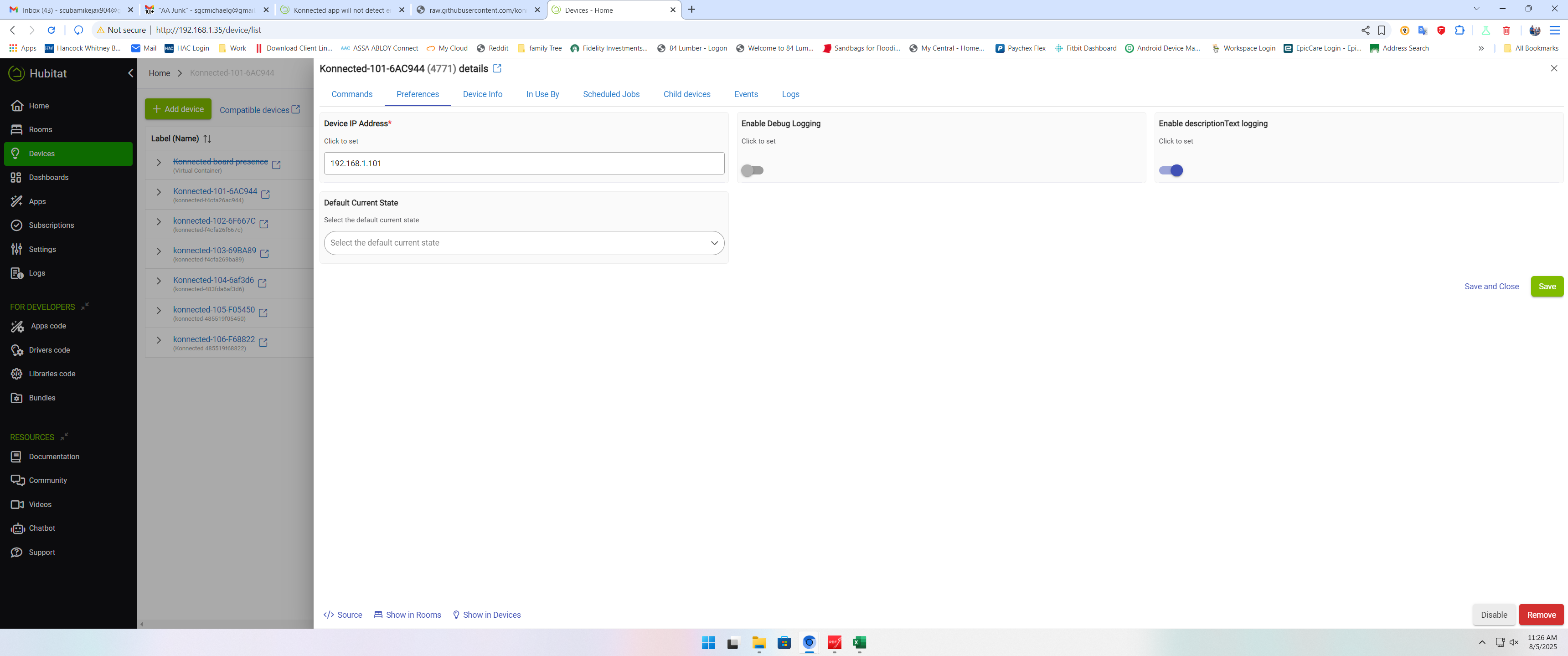

Preference tab

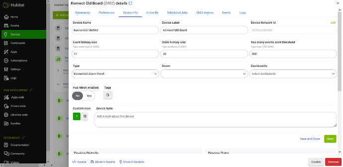

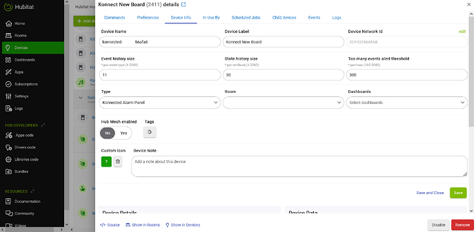

Device #1 Details

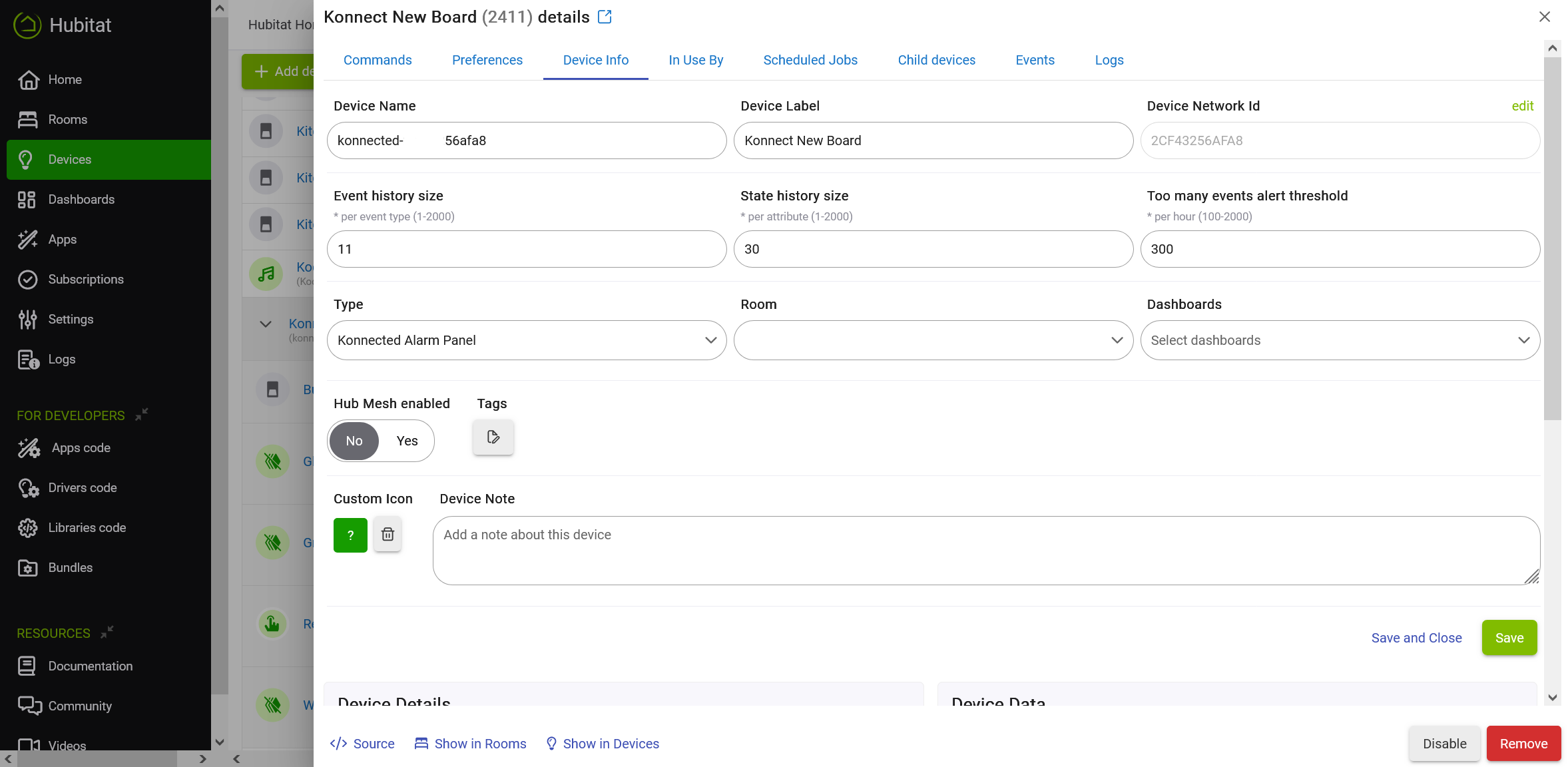

Device #2 Details

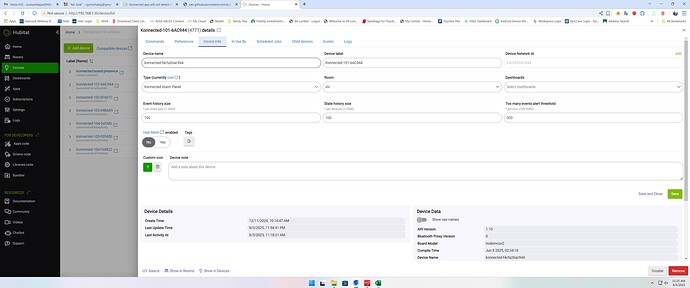

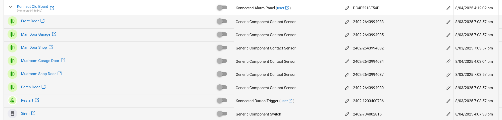

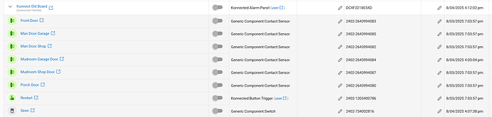

Devices
I could not get any response from the boards when using the Konnected contact driver, so I am using the generic one, and it is working.
Device Child Devices
