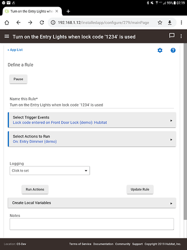

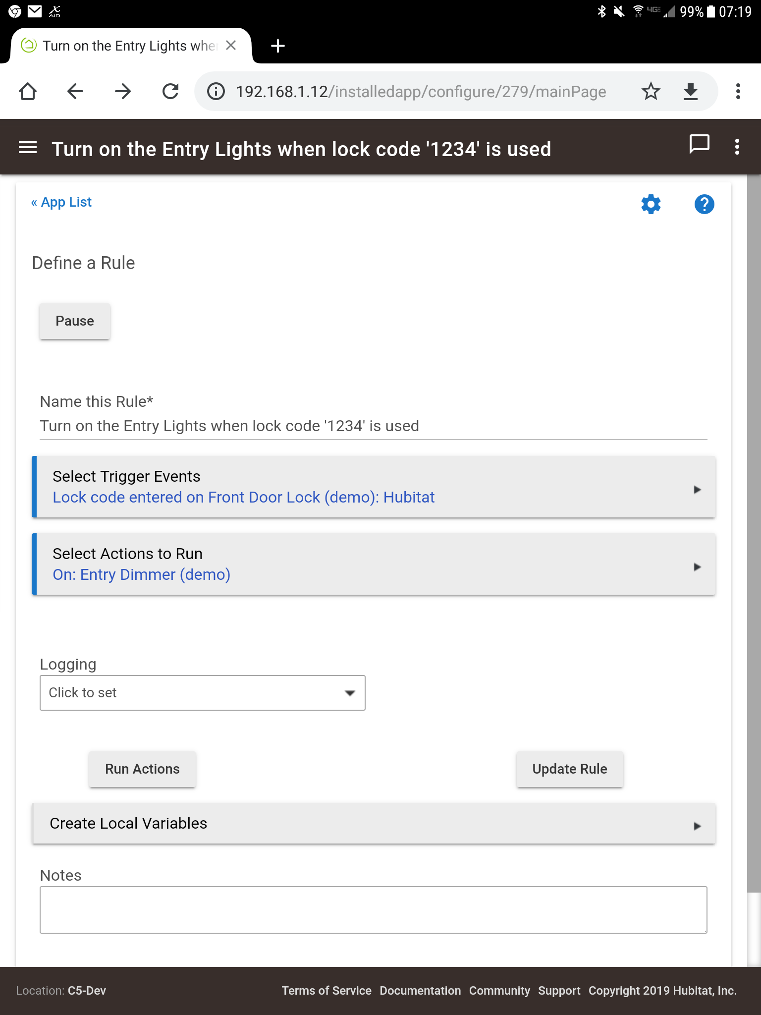

Sorry, @mike.maxwell. Don't want to use RM but from an user developed app. Which is why I posted in Developers and not Rule Machine. :wink::grin:

LOL, do you think I read the categories?
