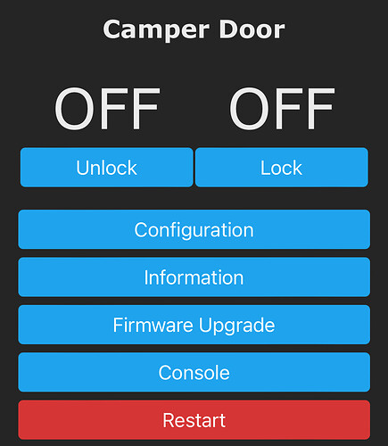

This morning I decided to work on the keyless entry. I connected 4 wires between the camper keyfob and a Wemos D1 Mini - 3.3v, gnd and two digital output gpio’s. I then removed the battery holder on the keyfob and put it all in an enclosure about the same size as the original key fob, and tasmotized the wemos. The whole thing stays powered off the 5v USB connection on the wemos; and now I have a sustainable means of locking or unlocking the camper door. Total cost - $3… and the sacrifice of the keyfob of course. Same concept should work on any vehicle keyfob as well.
