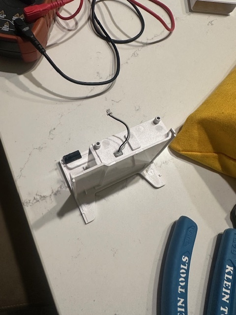

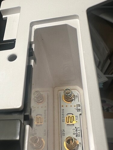

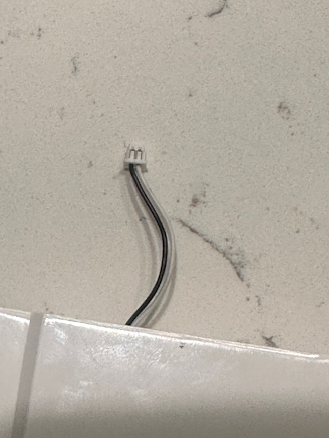

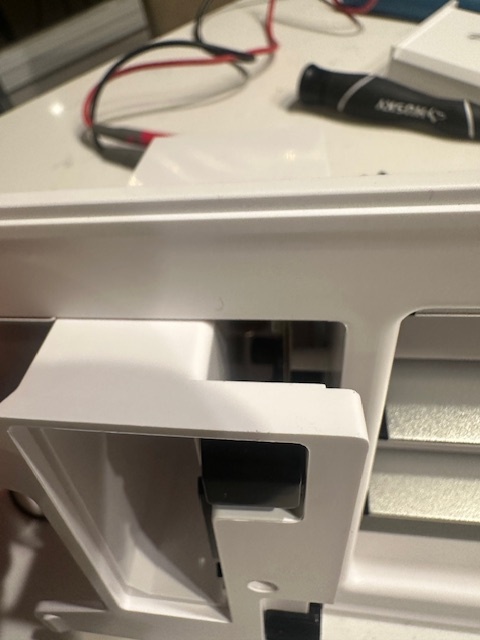

I'm dealing with a corroded battery pack where it ate through the bottom of the battery pack completely. I am going to perform a similar mod to what you did here but 3D print a replacement pack. I am fairly certain it's a JST1.25 2 pin connector, I have some being delivered tomorrow. Will report back my findings.
I can confirm that a JST 1.25mm 2-pin connector fits.

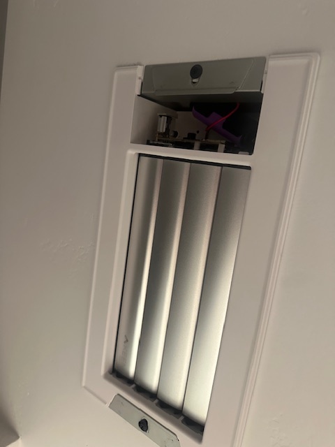

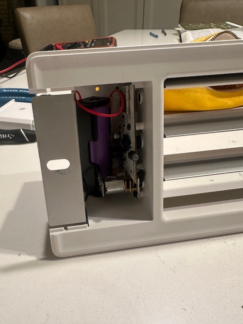

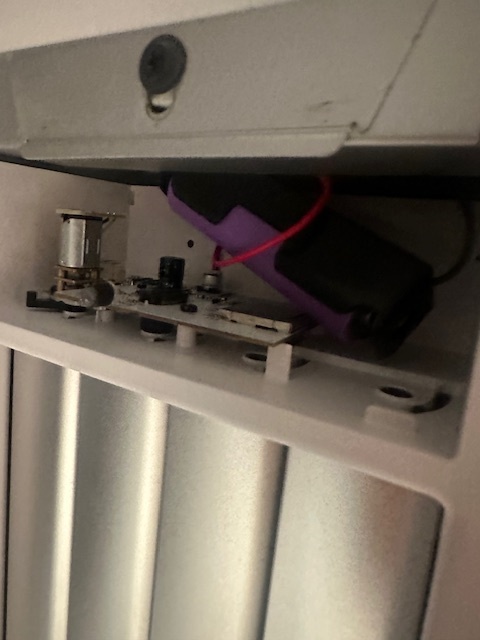

I replaced one battery pack with a somewhat generic purple color 18650 lithium battery (ASIN: B0B71R1VJ3). Originally it was fully charged and measured 4.2V. To my dismay, I found that battery measured 1.75V on 12/23/2023. The Keen Home Vent was still working (actually, it was the only one that was still working!) on 12/23/2023 but it stopped responding on 12/24/2023.

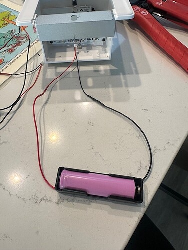

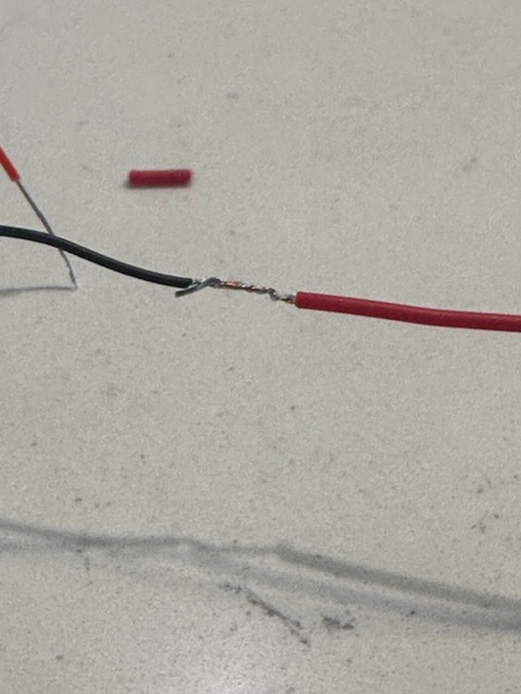

I chose three other vents that were measuring 0/0/1.3/1.3 to replace the battery packs with lithium batteries. I also recharged the original one that I worked on from 12/3/2023. Now, there are four lithium batteries installed: one purple battery (generic ASIN: B0B71R1VJ3), one yellow Victagen (ASIN: B0C4H138K6), and two lavender Samsung 35E 18650 3500mAh 8A battery (18650 battery store direct link).

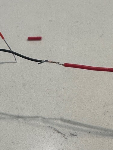

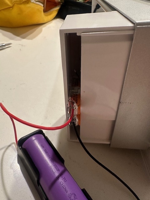

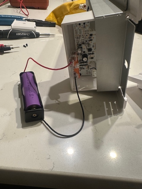

I did not bring my soldering iron with me, so I just twisted the wires together and used heat shrink tubing to hold them together. They seem to work. I will try to bring my soldering iron for the remaining connections.
By the way, I accidentally connected red to red and black to black wires, which reversed the polarity, and plugged the JST connector into one of the vents. Within seconds the magic smoke started coming out of the Keen Home Smart Vent. :fire: I immediately disconnected and fixed the problem. Fortunately the vent still works. I am relaying this to tell you just in case you accidentally miswire your connections. :laughing:
I am going to observe the battery life of these vents again. The first purple 18650 battery test is very discouraging, but the battery is generic, which is why I am trialing other batteries. If the life of the vents on lithium batteries is less than 3 months, we will have to give up on Keen Home (and by extension, Hubitat as the controller).
Here are pictures. Hope they help.
IMG_3335

The biggest issue with the vents is the battery "boxes" are prone to corrosion and because Keen is long gone, there are no replacements available. The fact the batteries "live" in an area with dramatic temperature swings likely leads to the issue.
