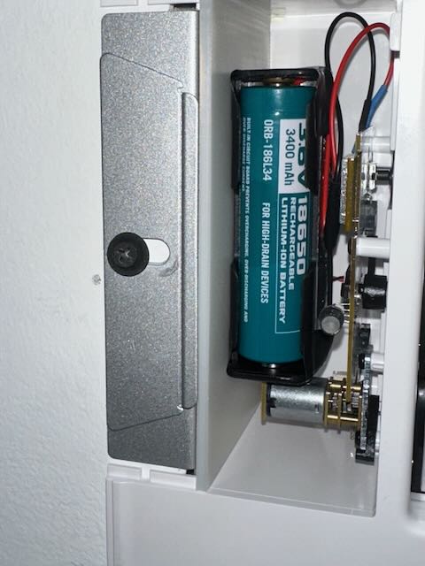

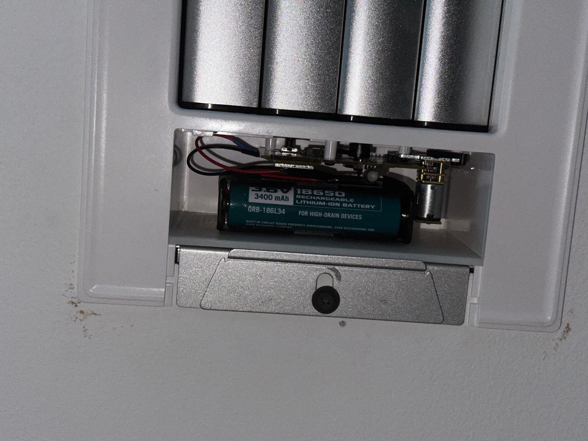

For what is is worth, I have 6 Keen vents in my basement. Like others, the battery pack inserts corrode, so I removed one vent, removed the battery pack insert and the battery pack holder. I used the exact same 16550 Lithium battery holder and JST connector as above (remember to reverse the colors when connecting them because the Keen vent JST connector is backwards from the red/black color code.

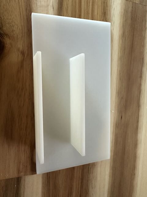

I 3D printed a piece that would fit in the place of the battery pack holder - it uses the same 2 bolts that the battery pack holder used, and I added place for the 16550 Lithium batter holder to mount (I used velcro for this case, but you can insert a bolt instead.)
Photos of 3D printed plate and installed vent:
