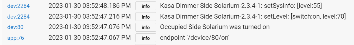

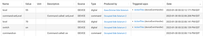

I am using the built in Kasa integration. When I send a command to the Kasa device from Webcore, the command gets processed by Kasa, but them immediately reverts. I am not giving it a command to change level to 55, I send command for 70. Really racking my brain on how to solve this one? Here is a screen shot of the device log of the Kasa device. Anyone have any suggestions? ("Occupied Side Solarium 2" is a Webcore Piston and "Kasa Dimmer Side Solarium" is the Kasa Hubitat device name)
And here is what the logs show - it looks like it is the "setsysinfo" that is reverting the level to 55, but I cannot figure out why?
It looks like the piston is trying to set the level to 70 but the device then responds that the level is 55. I think the setSysinfo is a reponse from the device.

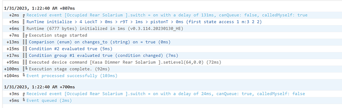

Here is the piston

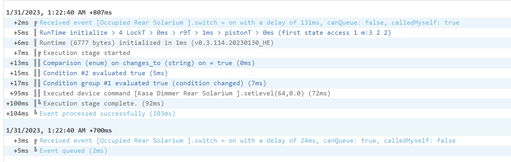

And the "Full" Webcore log
Debug logs is what we needed, you can see the device is responding with an error. Then the driver follows up by asking the device for a full report which it replies back with the same level it was at before.
