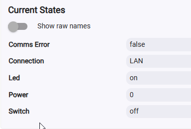

Is the Connection state showing LAN (like my screenshot)?
Otherwise the driver may be trying to reach the device via cloud, which then would result in that comms error. Maybe it is silently falling back to the LAN connection so still working.
Could also try running the configure command to rediscover the IP and it might reset the error.
