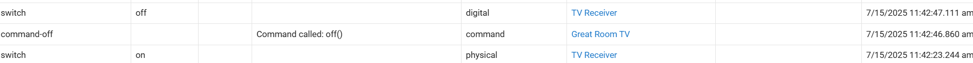

Here's the virtual switch turning ON....
Here, the Kasa device was already on...and you can see the virtual switch turning it off, when the switch was supposed to be turning it on...
Virtual switches can't turn anything off or on on their own. Some app, such as a rule, must be doing that. Without seeing that rule, or whatever app or apps are doing this, plus all logging from them, it's hard to tell what's really happening for you. If "Great Room TV" is an app (and all hints in your screenshot suggest it is indeed an app, like an RM rule -- though there is very little to go by), that is the one I would start looking at by enabling all logging, as suggested above.
The screenshots alone aren't problematic: an off command got sent to a switch, and it turned off. That is expected. If you're using a "toggle"-type action in an app and are expecting it to send an "on" instead of an off, that would almost certainly be because your device is not reporting its current state correctly back to the hub. (For example, at the moment before this command, it looks like it last reported as "on.) The hub needs the correct current state to "toggle" correctly, as that is an app feature, not a feature natively found as a device command on most Hubitat devices. Just a guess with the little given above...and something that may help narrow down your problem.
