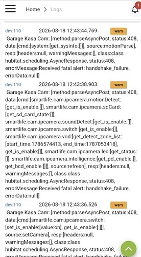

Hi @djgutheinz,
I believe I have found a Hubitat platform compatibility issue affecting the Kasa Camera Integration.
My Kasa cameras stopped responding through Hubitat after I upgraded the hub to platform 2.5.1.152 on Sunday, 16 August. They continued to work normally through the Kasa app.
Example camera:
Model: KC410S
Hardware version: 1.0
Firmware version: 2.3.27
Troubleshooting completed:
Turned Third-Party Compatibility off and back on in the Kasa app
Power-cycled the camera
Tested the camera directly from its Hubitat device page, bypassing all rules, virtual switches and Home Assistant
Both Privacy commands and Poll failed
Restored Hubitat to 2.5.0.159: still failed
Restored Hubitat to 2.5.0.143: camera control and Poll immediately worked again
Confirmed the Hubitat virtual switches, pistons and Home Assistant controls also work again on 2.5.0.143

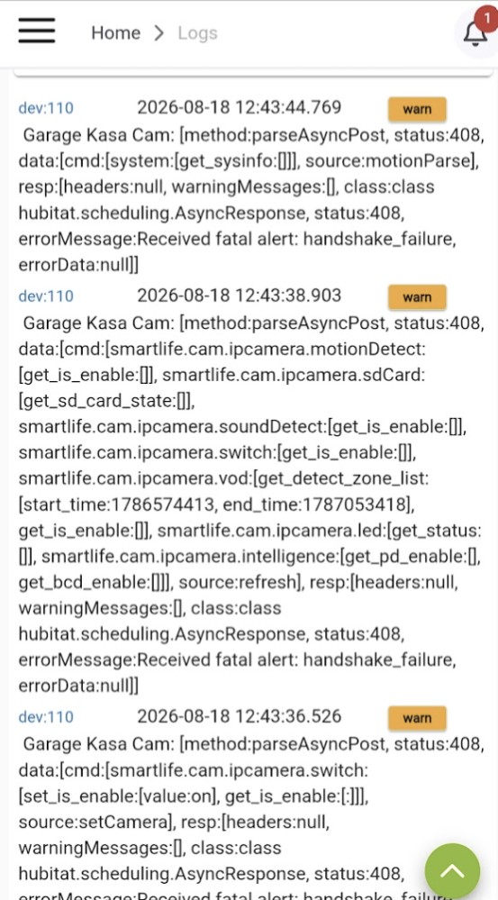

On the failing platform versions, Hubitat reports status 408 with:
Received fatal alert: handshake_failure
This affects both status requests such as:
system:get_sysinfo
and camera commands such as:
smartlife.cam.ipcamera.switch:set_is_enable
Therefore, the regression appears to have been introduced somewhere between platform versions 2.5.0.143 and 2.5.0.159—possibly alongside the IoT dependency-library update in 2.5.0.153.
I have remained on 2.5.0.143 for now. Please let me know if you would like additional logs, driver-version details or any other testing.
Thanks,
Steve
