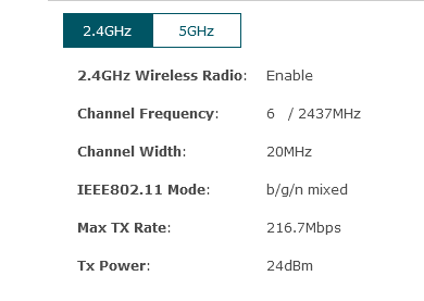

Don't forget that 2.4Ghz wifi and ZigBee overlap.

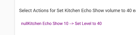

Went through every rule - found one small problem - I don't have a device called 'nullKitchen Echo Show 10" '... deleted action, and reentered it.

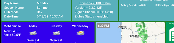

Regarding possible wifi interference, I've had no changes to Wifi AP's and router - but I went and checked anyway and still down at channel 6 on all 3 WiFi AP's/router. I run at channel x14 (20) on my Hub - nothing has changed inadvertently there but thanks for tickling me to go check.

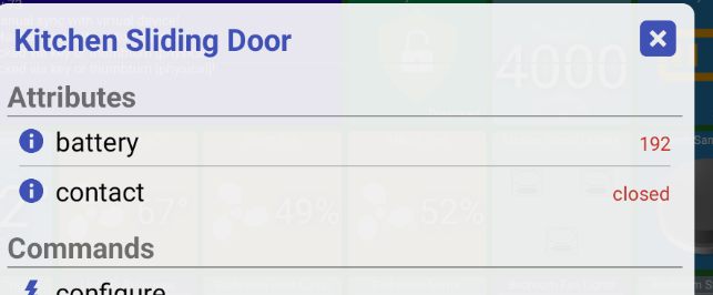

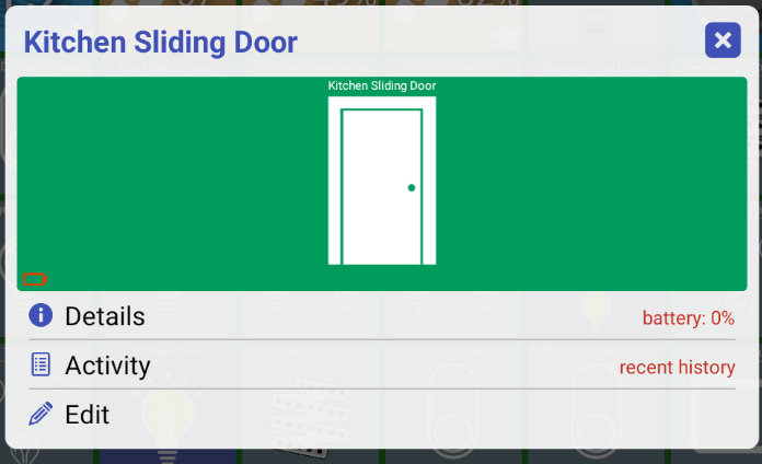

** update - that lasted about 45 minutes. One door contact sensor (A LinkIND) showed open when closed. Battery monitor's all said it was okay - 69%. I swapped the battery anyway and it came instantly back to life. But it's still screwy : on one screen it reports 192 on another it says 0.
***** Update - so I see someone else JUST posted elsewhere that his battery report on LinkIND is gone haywire. I have 4 of these units. Had not had a problem with them - they've been installed for 4-6 months, all of them. Maybe a battery lvl reporting problem in the driver?
