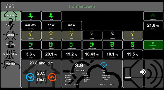

To get a bigger WAF at home, I smartened the fish tank a little.
Now we can read the temperature, control the pumps and switch the lights with Hubitat.
And OFC, create extra buttons on the dashboard
