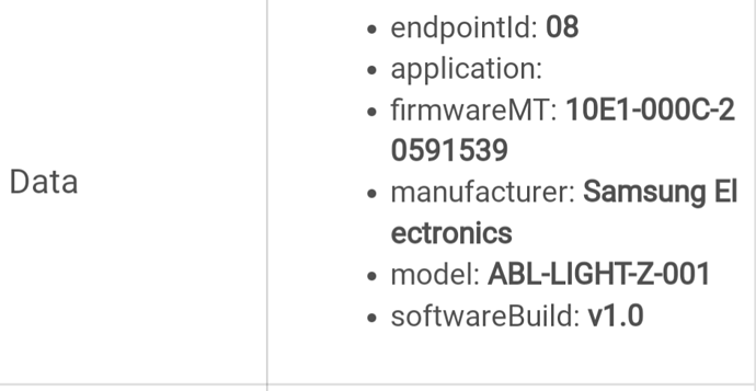

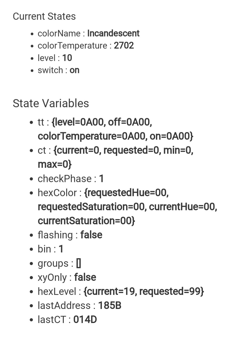

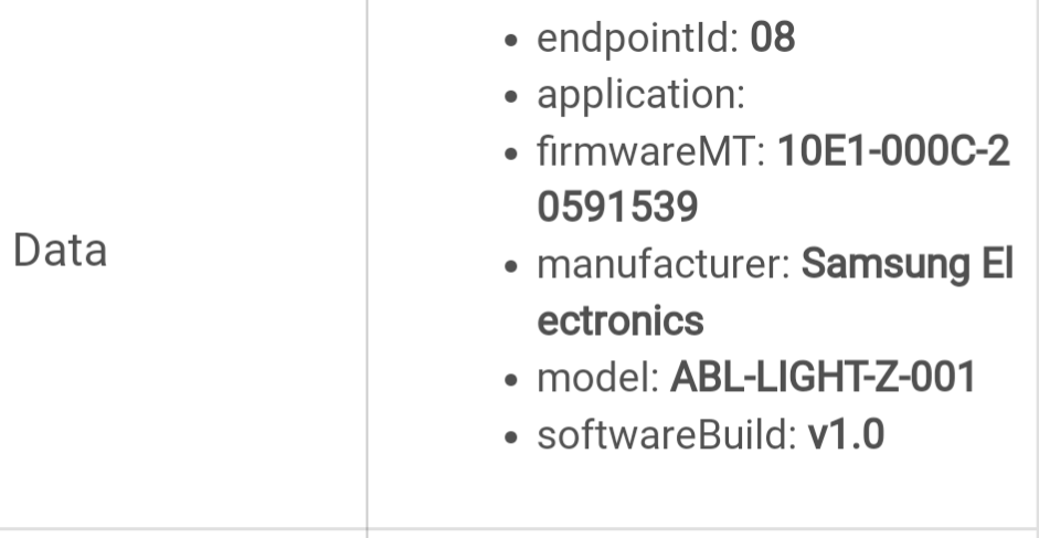

What driver did it join with, and can you post a screen shot of the state variables and data sections of the driver?, thanks

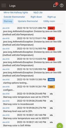

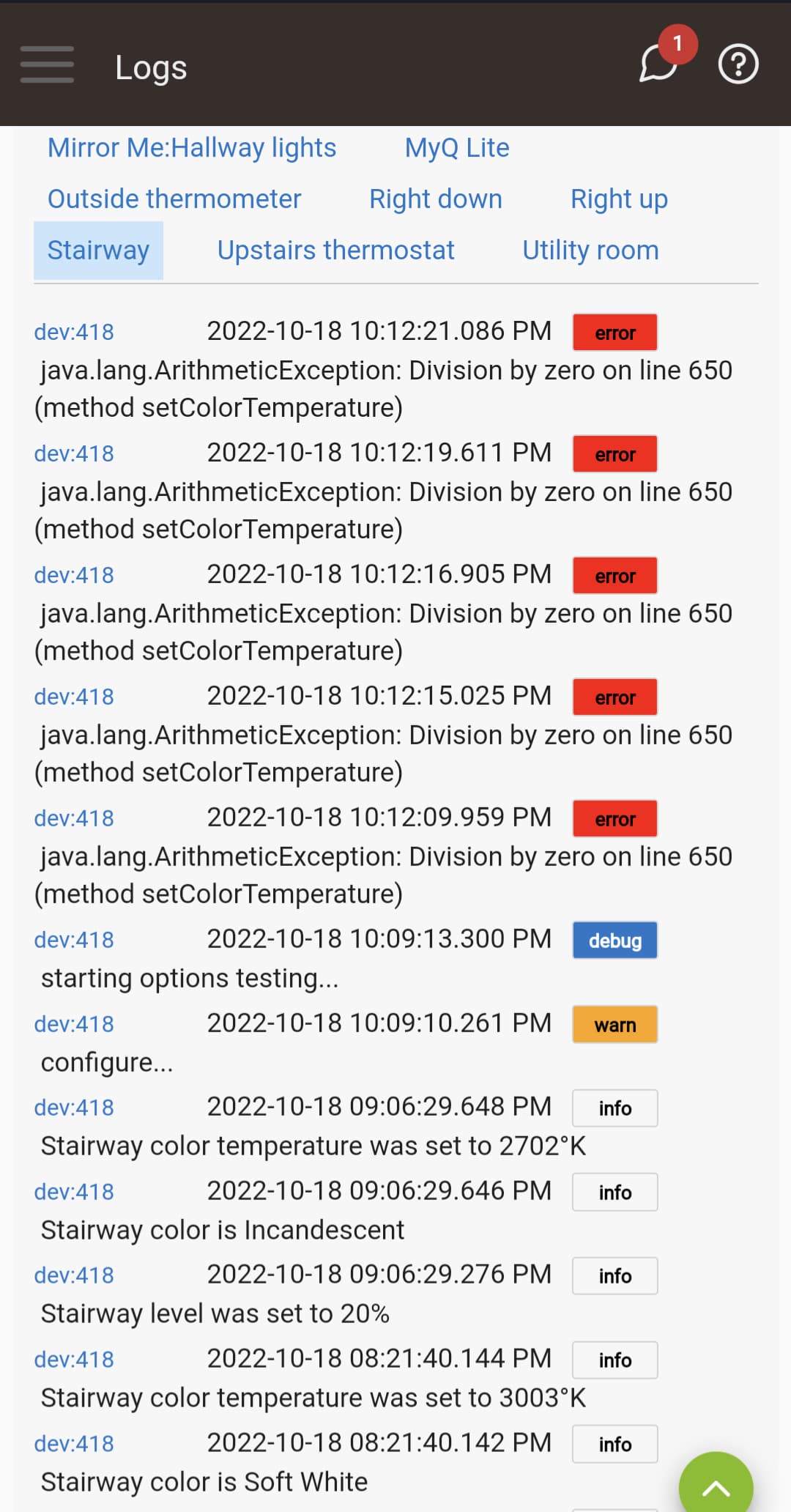

Huh, it doesn't look like the bulb made it through the options testing.

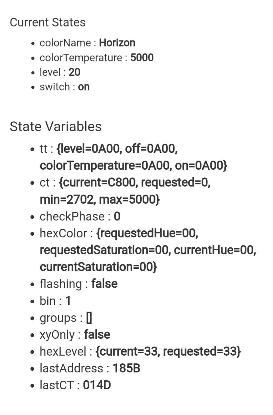

Can you click configure, then report what the state of the bulb is after the testing is completed?
The bulb should be on at 20% with a color temperature of 5000.
checkPhase in state variables should also be 0 after a page refresh.
do you get errors when adjusting the color temp now?
Sorry, long days at work. No errors adjusting color temps today and light responding well. Seems to be an intermittent problem though. Will check again tomorrow.
