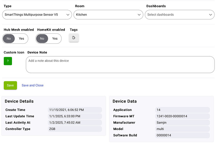

I just noticed I'm getting the following error when setting Three Axis reporting options to normal or maximum on the SmartThings Multipurpose Sensor V5 DTH. I know this has been working previously cause I have a different SmartThings Multipurpose Sensor V5 that is properly reporting 3 axis data that I'm actively using. Current hub version is 2.4.0.145

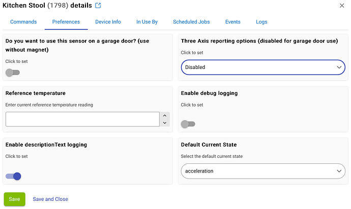

Disabled, i get the error in the log when i change it from disabled to either normal or maximum. My goal is to enable this feature on the device so i can use Three Axis reporting fo an automation, but i never get Three Axis updates all i get is the error.
Reference temperature is not set. i dont use this device for temp so changing the Reference temperature for troubleshooting is not an issue. Let me know if there is any value in changing the Reference temperature.
