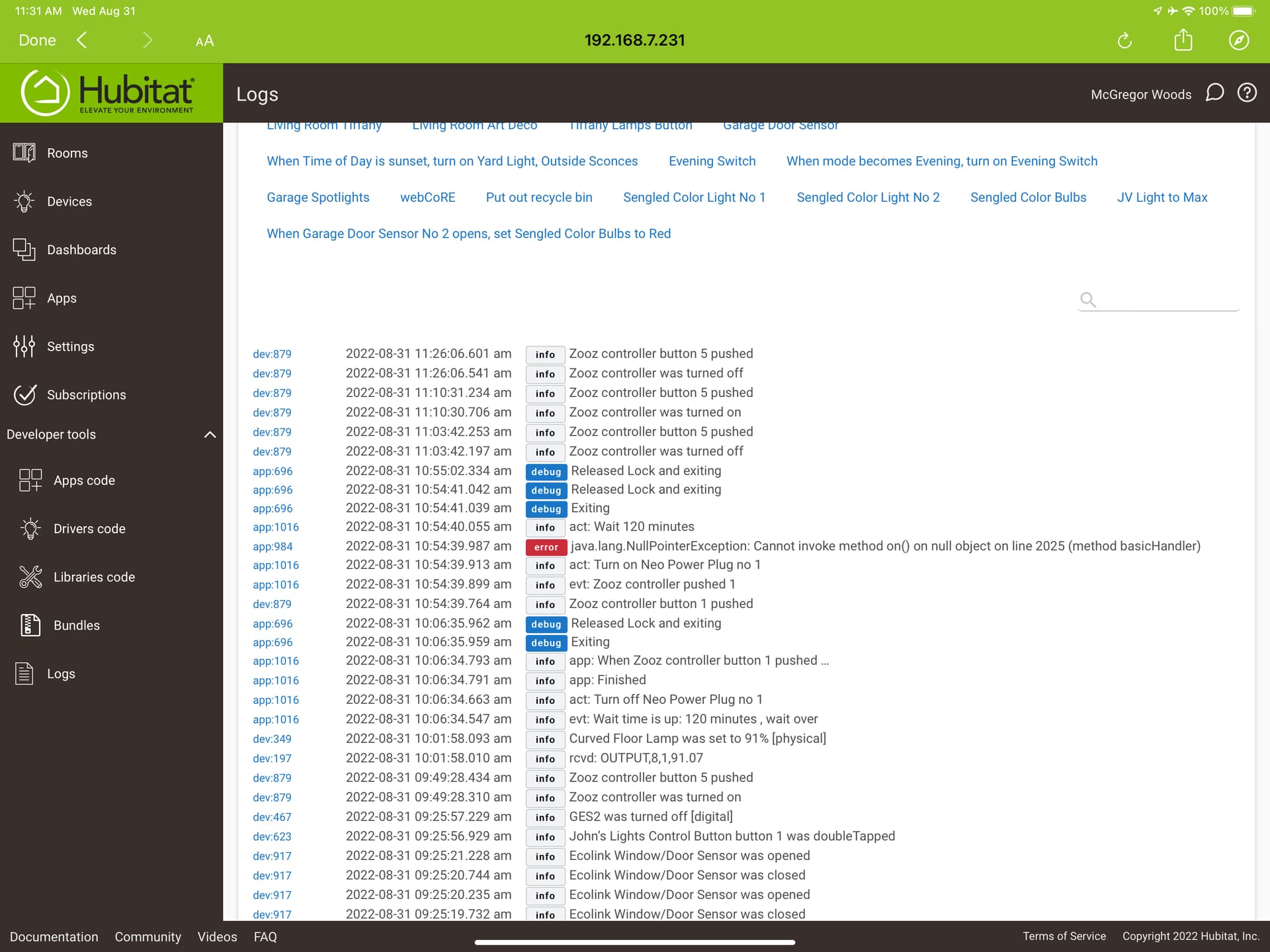

All of a sudden, I get the following when I push a Zooz device button. This has been working for quite a while.
errorjava.lang.NullPointerException: Cannot invoke method on() on null object on line 2025 (method basicHandler)
Could you please post a screenshot of the logs? The snippet you posted is not complete. I also removed the Zigbee tag from your post title, because I belive that Zooz devices are all Z-Wave, not Zigbee.
Thanks. I don't think is related to a specific Zooz button, but rather the app 984 is missing a device and can't turn on what doesn't exist. Mind sharing the details of app 984? Is likely that you've removed a device from your system and the app now has an empty field for the action to turn on devices.
How do I find app 984?
