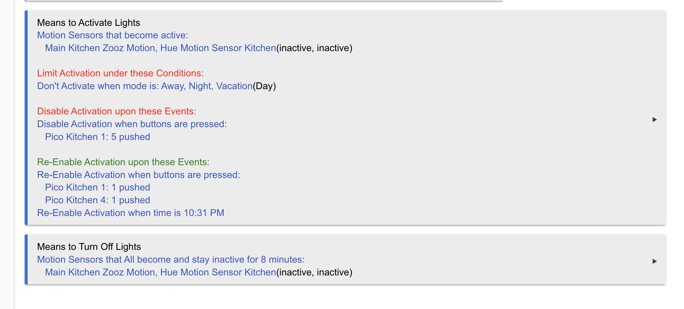

I use motion sensors in Room Lighting to activate light switches. I want this disabled at night so the dog doesn't activate the lights all night long. I have the app to limit activation when the mode is Night. I also have a Pico that can disable the motion earlier than when the mode changes to night (if we go to bed early). Is there a way to re-enable activation based on the mode going back to day? I have to use the Pico to re-enable activation in the morning if I disabled it at night with the Pico.

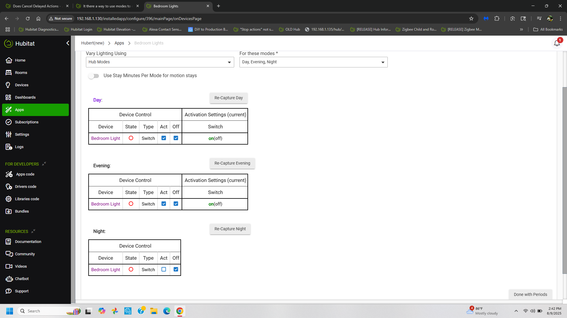

Set it up using the hub modes like my screen shot. Notice night has only off ticked, that way if you turn on a light with a switch it will still turn off.

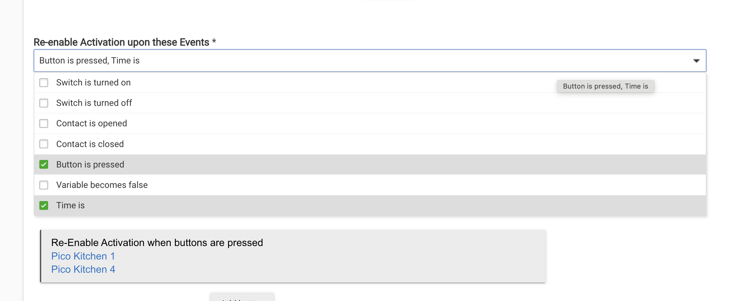

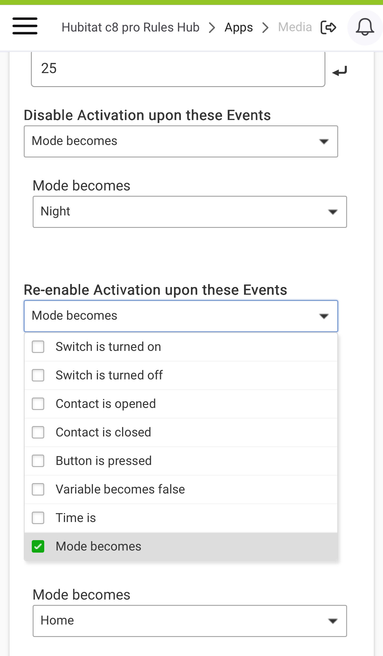

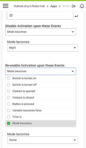

The room lighting devs kindly added this feature in recently so you don’t need to create any work around and is all contained in the RL app:-)
