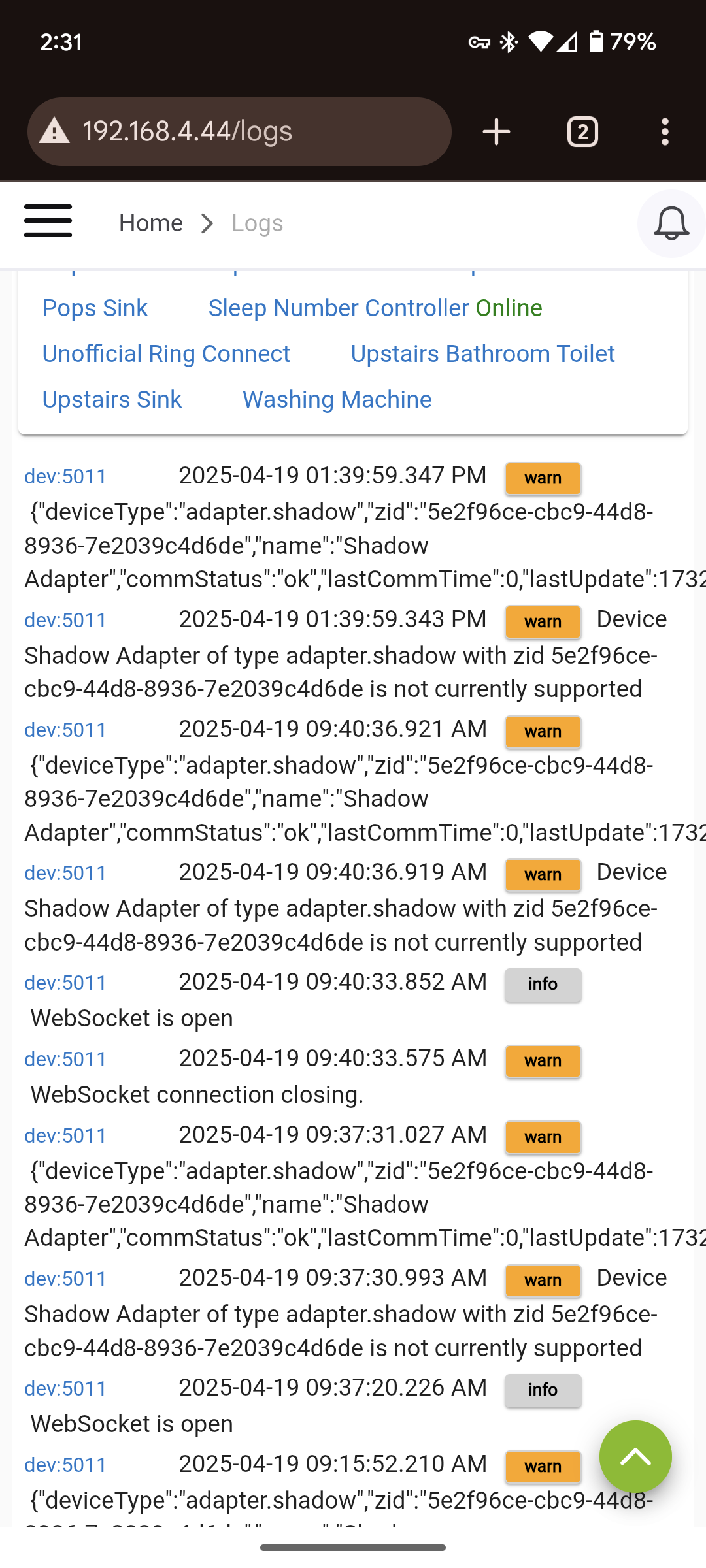

What app or driver is producing the error?
Post a screenshot of the logs so we can see the full context.
Device 5011 says Home Location, what ever that is b/c that is not one of mine
At least since the update the the latest, I'm only seeing the warning and not the error for the same device
If you click the orange "warn" text it will open the device in a new tab. You need to see what device it is, and what driver it is using.
Looks like some problem with your Unofficial Ring Connect integration (or maybe not a problem, as I have no idea what logging is normal for that device or what options you have enabled) -- based on a cursory glance of its code and the fact that some of it matches log entries you provided. (But it's always good to share what device and driver this is, as the above posts tell you how to do. This was a lucky find on my part.)

I wasn't aware of selecting the warning to get to the device... yes it was Ring which I am not using so I deleted it

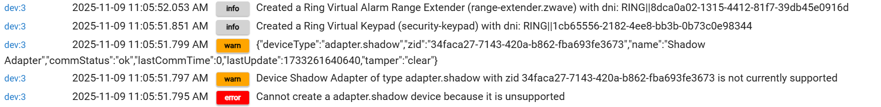

I am using the Unofficial Ring Integration and it's been working pretty flawlessly for a couple of weeks and then I too started getting this new error/warning a couple of days ago. I'm guessing that Ring may have changed their "API". I might try tracking down the developer in the app support page,
Thanks for the clue to click the orange warn text. It takes you back to the Ring device container - the top level container associated with your location.
Reaching out to @ardichoke or @morse.caleb to see if anyone is still supporting the code base. I installed Caleb's (no version history I can refer to unfortunately) and my Ring Alarm integration has been working great except for the new error above "Cannot create a adapter.shadow device because it is unsupported".
Any updates on this?
The "zid" is of a different range (the first segment is in a totally different range than any of my other devices).
It appears that some part of the Ring system is spinning up a new virtual device (type "adapter.shadow") and the code for the integration doesn't know what it is.
