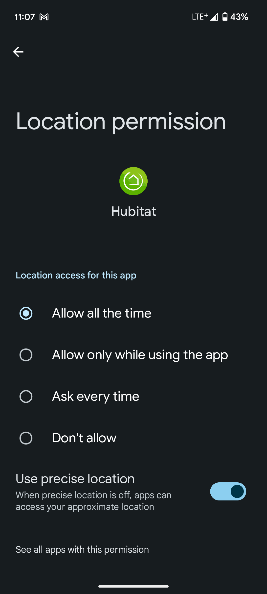

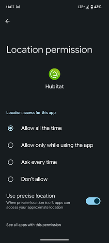

I'm having a hard time getting my pixel 7 to work as my presence sensor with the app. I'll be in/out of the geofence, and it will show in the app, and on the device list online
All of a sudden about 3 weeks ago it stopped working and I can't seem to get it to work again.
I had similar Android issues. Make sure your location sharing is still approved for the app.
Yeah the permission is set to all the time.

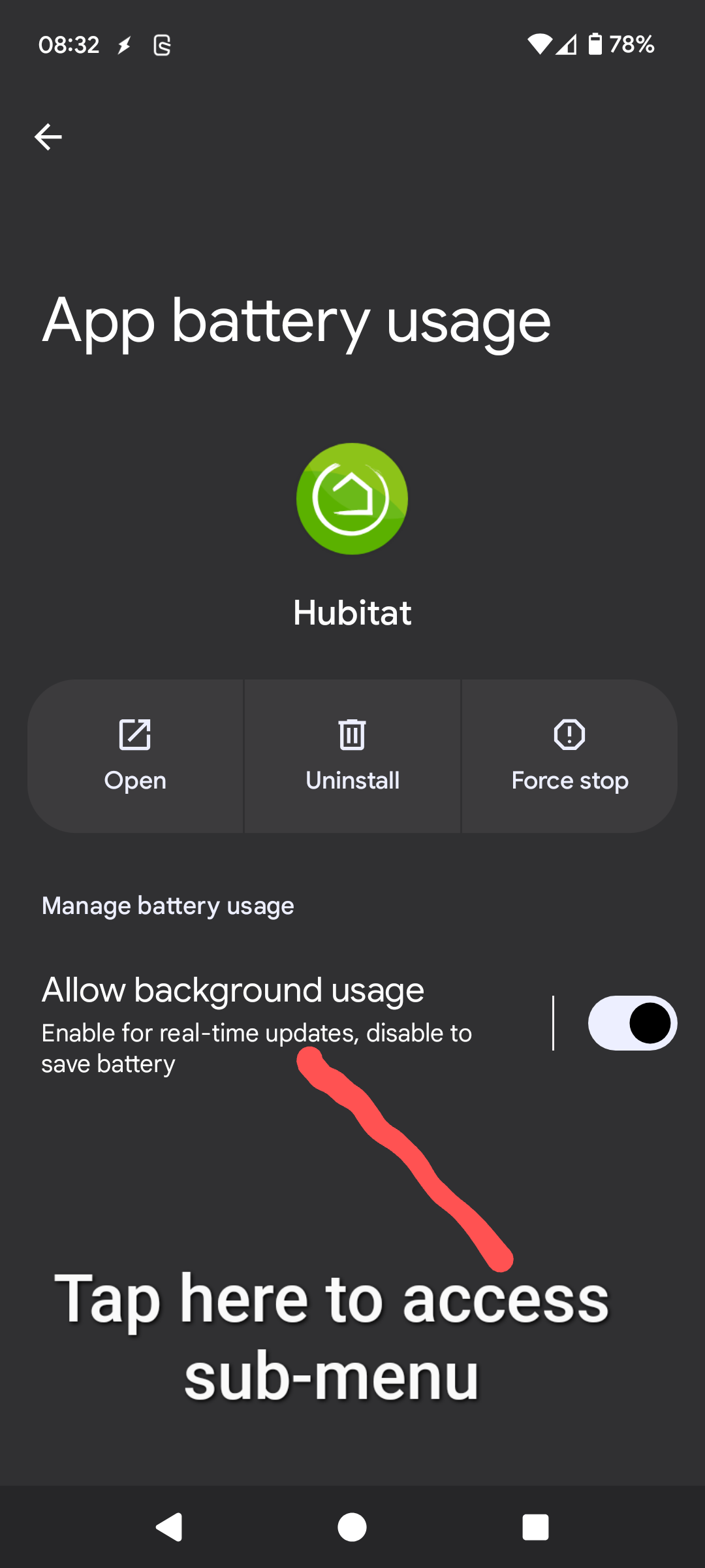

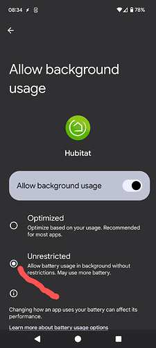

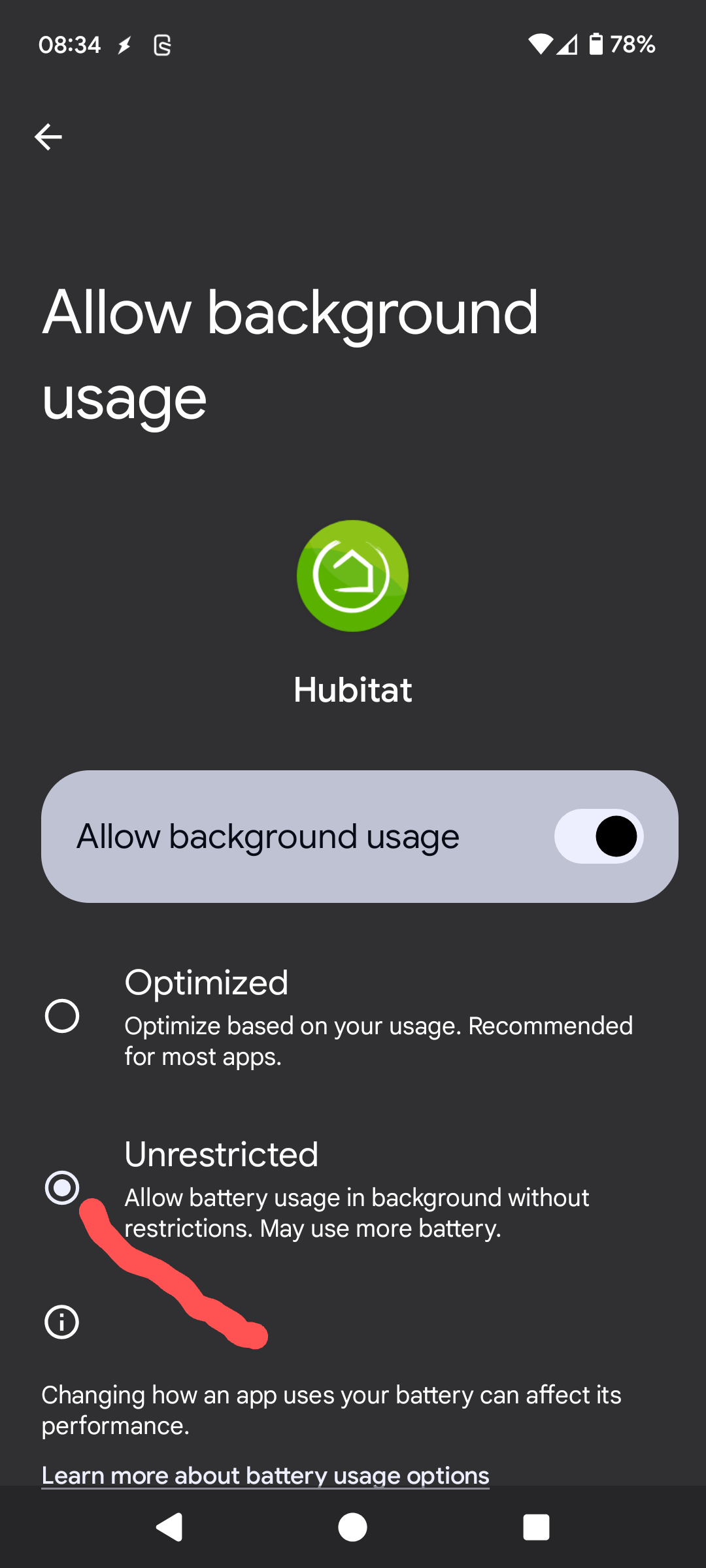

All the above plus in the battery settings allow hubitat to operate in the background.
In addition to the location permissions, also check the battery permissions.
I didn't know about that one, I changed it and hopefully it fixes the problem.
It is very well hidden...
