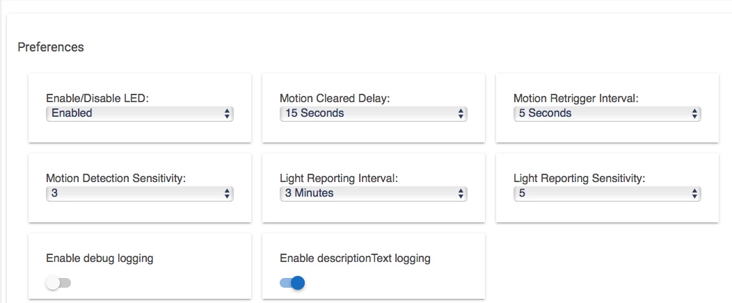

Here are the settings. Right now with a track light aimed right at the sensor it shows a lux of 3
Change it to most sensitive for light, I think it's #1 and then open the device and hold the tamper button for 1 second.
Thanks, I'll give that a try
That definitely helped. I reset it per your instructions and got a value of 28 (light on) and (2) light off. I play around with it. Thanks for the help...
