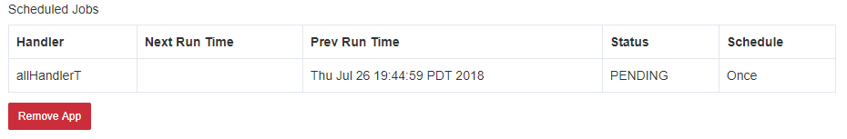

Today, the info for that rule is showing "Scheduled Jobs": None.
It wouldn't be the end of the world if I had to remove the rule and re-do it using a couple of Simple Lighting rules. (Or perhaps I'll go into the Restrictions and specify that it can run on each day of the week.) I guess I'm just trying to understand normal behavior, but on the other hand if something is broken, I wanted to let you know.
Is this not the big that was supposed to be resolved recently where http calls weren’t timing out and were killing the scheduler? I notice the next run time in the last screenshot is blank but the status is Pending. That’s what I experienced with my Smart Lighting not working on some rules that turned out to be a custom app making http calls, bogging down the system and killing the scheduler.

I was just trying to point a similarity to the issue I had with scheduling in that the schedule showed it was pending an action but the Next Run Time was blank. It would blank 2 minutes after missing execution of a schedule.

When I look at the info page for it, there is nothing showing as scheduled.
