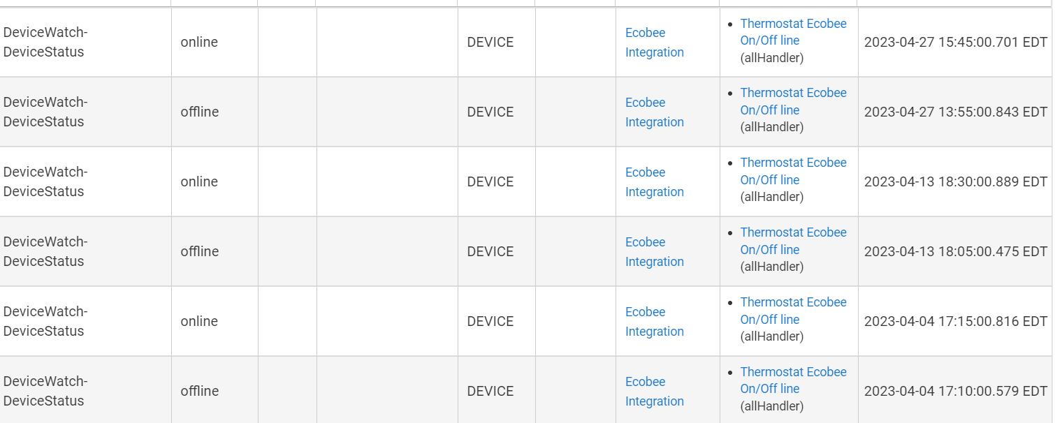

April's Ecobee Offline events

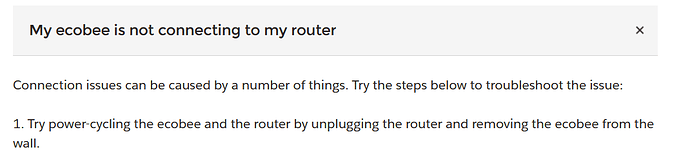

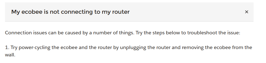

Their support also tells you to do this when troubleshooting wifi or connection to their servers
https://support.ecobee.com/s/articles/Wi-Fi-FAQ-Setup-Guide-and-Troubleshooting
