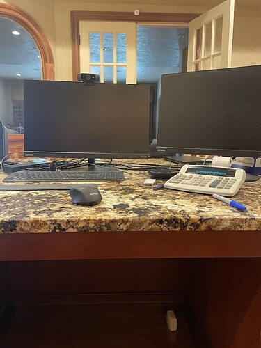

Edit: added picture of my solution:

Boy that's an odd looking keyboard for the right hand screen. Are you an historian?
Hmm, gives a new meaning to "his went lights out"
LOL - I was going to congratulate him on the retro look.
Haha. I suppose I did sort of give my profession away with that photo. Old school accountant who still can't get by without an adding machine.
But no paper tape !
I love that desk top!
